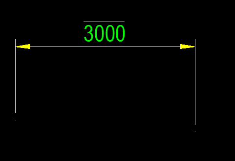

hello all:
Can someone help me modify this routine?
This routine adds a line about texts and mtexs and it is very helpful to me but sometimes instead of texts or mtext I have dimensions
I would like the routine when selecting and detecting dimensions to also add a line above its value.
I hope someone knows.
here the code

@leonucadomi Try This:
;; original code by RonJonP, edited by P. Kenewell
(defun c:ltx (/ o s)
  (command "._undo" "_be")
  (if (setq s (ssget ":L" '((0 . "*TEXT,DIMENSION"))))
    (foreach e (vl-remove-if 'listp (mapcar 'cadr (ssnamex s)))
      (setq o (vlax-ename->vla-object e))
      (cond
         ((= "TEXT" (cdr (assoc 0 (entget e))))
            (vla-put-textstring o (strcat "%%U%%O" (vl-string-left-trim "%%U%%O" (vla-get-textstring o))))
         ((= "MTEXT" (cdr (assoc 0 (entget e))))
            (vla-put-textstring o (strcat "\\L\\O" (vl-string-left-trim "\\L\\O" (vla-get-textstring o))))
         ((= "DIMENSION" (cdr (assoc 0 (entget e))))
            (if (= (vla-get-textoverride o) "")
               (vla-put-textoverride o "\\L\\O<>")
               (vla-put-textoverride o (strcat "\\L\\O" (vl-string-left-trim "\\L\\O" (vla-get-textoverride o))))

@leonucadomi Actually - I think this version will work better i it will prevent it from stripping other formatting for the reason Lee Mac noted here:
; Original by RonJonP, edited by P. Kenewell
  (setvar "cmdecho" 0)
      (cond
               (strcat "%%U%%O"
                  (vl-string-subst "" "%%U"
                     (vl-string-subst "" "%%O" (vla-get-textstring o))
               (strcat "\\L\\O"
                  (vl-string-subst "" "\\L"
                     (vl-string-subst "" "\\O" (vla-get-textstring o))
                  (strcat "\\L\\O"
                        (vl-string-subst "" "\\O" (vla-get-textoverride o))
  (command "._undo" "_end")

THANK YOU THIS IS PRECISELY WHAT I NEEDED
