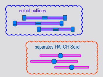

Fill in several outlines with separates hatchings
Is it possible to use lisp to shade selected outlines (several at once) with separates hatchings Solid?
There are many polylines (rectangles) that need to be filled with separates hatchings...
How can this be applied to multiple outlines:
(vl-cmdf "_.-hatch" "_s" r "" "_p" "SOLID" "" "" "")

just use toggle 'Create separate hatches'
  • Thanks 1
I know this, but I have a lot of outlines in my drawing, and it takes a very long time to highlight each of them...

17 hours ago, rlx said:
(defun c:t2 ( / al ss)
  (setq al (vla-get-activelayout (vla-get-ActiveDocument (vlax-get-acad-object))))
  (princ "\nSelect objects to apply solid hatch to : ")
  (if (setq ss (ssget (list '(0 . "LWPOLYLINE"))))
    (vlax-for o (setq s (vla-get-activeselectionset (vla-get-activedocument (vlax-get-acad-object))))
      (setq h (vla-addhatch (vlax-get al 'block) acHatchPatternTypePredefined "SOLID" :vlax-true))
      (vlax-invoke h 'AppendOuterLoop (list o))(vlax-invoke h 'Evaluate)
@rlx thank you very much!!! It will help me a lot.

12 hours ago, BIGAL said:
Post a dwg. Should be able to use Hatchb.lsp to make a boundary and get the points of the boundary, if its more than 4 vertices or small sides are different lengths then it's not really a pline shape.
I am trying to convert (using the program SOLID_PLINE_HATCH_TO_PLINE) the created hatches into a polyline with global width=hatching width, but an entry is displayed on the command string:
"The outline of the hatching is formed not only by a polyline".
If the hatching is created by the autocad command, then the SOLID_PLINE_HATCH_TO_PLINE program works...
PL_HATCH.dwg Solid_pline_hatch_to_pline.fas.rar
Edited by Nikon
Sorry no help to existing code  if your using a FAS file. I use Bricscad mostly now and fas is not supported.
This is close to what you want, I have not looked at color of hatch but that could be added. Change layer name, the rectang around the hatch is erased, the hatch is still there on Hatch layer, again could be erased.
You were lucky did the d1 d2 bit yesterday for another post.

Mr. @BIGAL This is an amazing program!!!  I couldn't find this solution for a long time... Thanks a lot!
A very good start to the day! Thanks for Rect2pl.
Edited by Nikon
No worries as I had solved already the shortest side it was easy to do. :beer:
