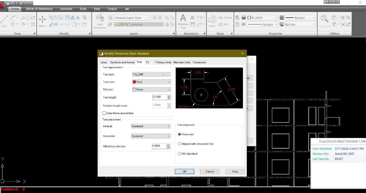

Vijay Posted September 10, 2024 Posted September 10, 2024 Dimensions are not visible. They appear only when I zoom in on the drawing. My AutoCAD version is 2009. Quote
SLW210 Posted September 10, 2024 Posted September 10, 2024 Computer specifications and Operating System? Quote
Vijay Posted September 10, 2024 Author Posted September 10, 2024 Os is windows I5 10300H 2.50ghz 8gb ram 1650ti 4gb Quote
SLW210 Posted September 10, 2024 Posted September 10, 2024 This is a Laptop? What Windows? Graphics card driver? Quote
Vijay Posted September 10, 2024 Author Posted September 10, 2024 Yes this is a laptop Windows 10 32.0.15.6094 Quote
BIGAL Posted September 10, 2024 Posted September 10, 2024 Need brand of graphics card, have known internal Intel graphics to have problems. If you have a second graphics card, you can set CAD to use it. Example my laptop has a NVIDIA Geoforce. Quote
SLW210 Posted September 11, 2024 Posted September 11, 2024 Windows 10 is not compatible for AutoCAD 2009 and AutoCAD 2009 was Windows XP and Vista, not even 7. AutoCAD 2016 with service pack, IIRC, was first for Windows 10. Have you set a compatibility mode? If so, which one? See this...How to Make Old Programs Work on Windows 10 (howtogeek.com) There is always...Longbow Software. You could try Hardware Acceleration OFF, it could fix it, worth a shot, or using reduced settings. It may help to see if there is a newer driver, or even a rollback to a previous may fix the issue. 1 Quote
Vijay Posted September 12, 2024 Author Posted September 12, 2024 Thank you my problem is solved Quote
SLW210 Posted September 12, 2024 Posted September 12, 2024 5 hours ago, Vijay said: Thank you my problem is solved Can you specify what the solution was for future people that encounter the issue? 1 Quote

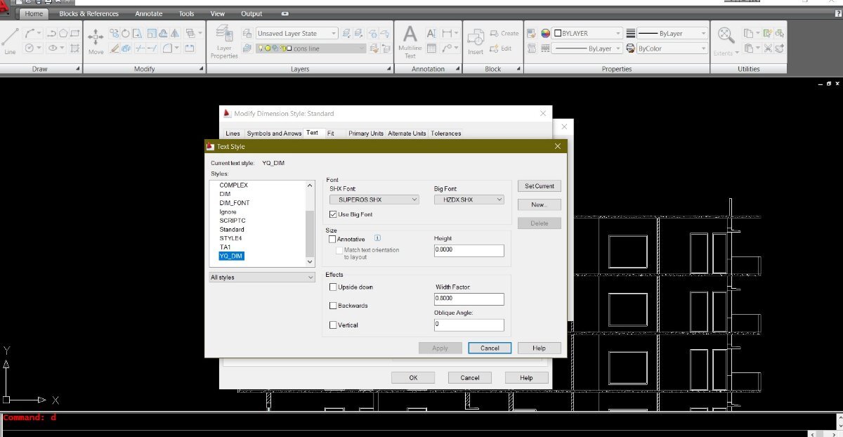

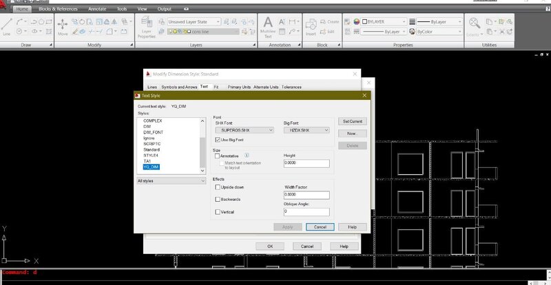

Vijay Posted September 12, 2024 Author Posted September 12, 2024 (edited) I just changed the dimension (Default)text style... Edited September 12, 2024 by Vijay to add more Quote
