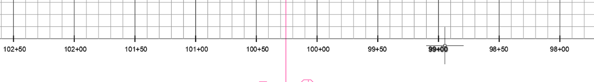

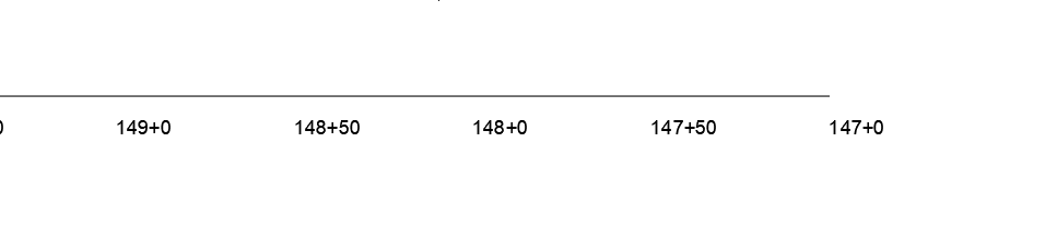

image.thumb.png.c4419f726f61eada48bf74c0ccb112f9.png<--Looks like this (seems like every other one is missing a digit)

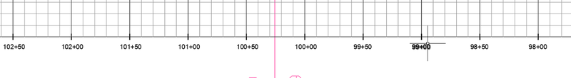

image.thumb.png.ce5c3b7ec8ea2bc41bf92b172bf3bd03.png <--- Should look like this
I made this to station a profile grid without having to manually enter stations for long jobs.
They go in increments of 50 and if below 1000 they have a 4-digit convention with a leading zero. like 00+50.  If above 10,000, they are formatted like 100+50;
Where did I go wrong here? Also leading zero isn't working.
Here is the lisp. Thanks guys.

Try this:
  (defun format-station (station / Hundreds Tens)
    (setq Hundreds (itoa (/ station 100)) )   ;;Split out the 'hundreds'
    (setq Tens (rtos (rem station 100) 2 0) ) ;;Split out the 'tens'
    (while (< (strlen Tens) 2)      ;;Change '2' here to the string length including leading zeros.
      (setq Tens (strcat "0" Tens)) ;;Add a leading zero
    ) ; end while                   ;;repeat if string length is still too short
    (strcat Hundreds "+" Tens)      ;;Create text
