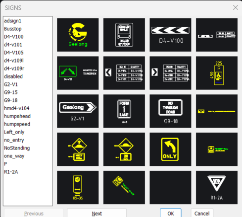

BIGAL Posted September 6 Share Posted September 6 A comment, do you know how to make a pop menu or a tool palette ? This is a very easy way of choosing your block to use. You can have multiple groups of blocks so choose from one catergory a sign of the one type. Same with your speed tables which at moment in this dwg are A$C261F4F67 rather than proper block name. There is ways of short cutting the making of a mnu. Quote Link to comment Share on other sites More sharing options...

Akanezuko Posted September 9 Author Share Posted September 9 On 9/7/2024 at 4:43 AM, BIGAL said: A comment, do you know how to make a pop menu or a tool palette ? This is a very easy way of choosing your block to use. You can have multiple groups of blocks so choose from one catergory a sign of the one type. Same with your speed tables which at moment in this dwg are A$C261F4F67 rather than proper block name. There is ways of short cutting the making of a mnu. No I don't know how to make this. I am new in this field. Quote Link to comment Share on other sites More sharing options...
BIGAL Posted September 9 Share Posted September 9 (edited) Ok making a mnu file is easy using notepad, you load a mnu file using the Menuload command. A menu can have pop menu's, toolbars, images and digitiser. All in on menu. This method is very old so the images are Slides just do MSLIDE it will capture your current cad image Vslide lets you have a look at it. You can use a lisp to make the slides I have made like a 100 in one go. Were I used to work we tended to have all the blocks as separate dwg's but saved in a common directory and only had the blocks that we really needed in the dwt. The pop menu in the image has like 130 lisps behind it. Ok how to start, the simplest is make a pop menu for say your DWT that matches all the blocks inside it. Like your sample dwg. Fix the blocks by using rename for the blocks that are named A$C261F4F67 etc. Send me a PM with say this dwt attached and will get you started. You can add more blocks even in other dwg's. Edited September 9 by BIGAL Quote Link to comment Share on other sites More sharing options...
