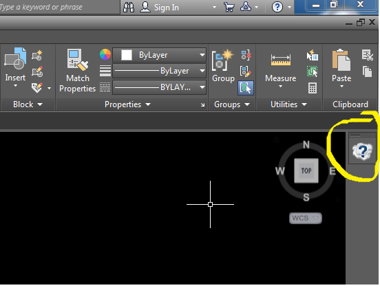

hello guys
can you tell me how i can set a name instead image(question mark) for my customize toolbar, ?
That usually occurs when the image can not be found, check where your image is saved make sure in a support path.
Post the toolbar mnu code.

can you tell me what " [_button ] " do ?
i couldnt use your code in my autocad!
Save the 1st toolbar menu into notepad and save as say Moham.mnu then use menuload to load that menu you should then see it. It is an example of a toolbar menu.
The second menu contours has custom icons that I made and saved as BMP images. The images need to be 32x32 pixels.
The mnu file you posted appears to be a default acad.mnu, you do not need to edit that you can have custom mnu's made by you.
If you can explain more what you want int the tool bar.

"Actually, the main problem is that when I load my own menu, the default AutoCAD menu changes, and I lose the main menu. So, what's the solution? I just need a temporary menu that I can load when needed, and then it disappears after closing AutoCAD."
Ok as I have said before CUSTOM mnu. The mnu you have is a Acad.mnu so yes it will overwrite your normal menu.
The menu samples I posted are complete no more info is needed. A pop menu is made up of parts, Main, toolbar, image,  digitiser. The parts can happily work on their own. The Ribbon though has to be done via the CUI. But over at Bricscad forum is a use Excel to make a cui.
So again post what commands are you looking for !
As a comment I used "drafting workspace" but had CIV3D commands in that workspace via a custom menu. So you can mix and match various workspaces.
