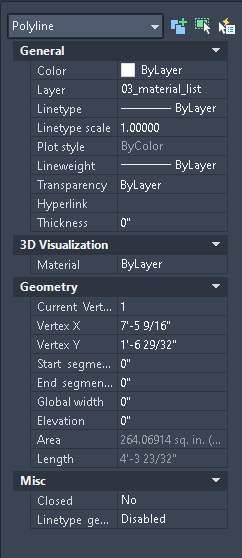

Additional information
Still need a sample drawing not an image.
Did you LIST the PLINES? If you just select the pline and Properties, it shows as Polyline if it's a LWPolyline.
From LIST...
LWPOLYLINE  Layer: "03_material_list"
                            Space: Model space
                   Handle = 2fb
              Open
    Constant width     0'-0"
              area   264.07 square in. (1.8338 square ft.)
            length   4'-3 23/32"
          at point  X=7'-5 9/16"  Y=1'-6 29/32"  Z=    0'-0"
          at point  X=5'-10 23/32"  Y=1'-6 29/32"  Z=    0'-0"
          at point  X=5'-10 23/32"  Y=0'-4 29/32"  Z=    0'-0"
          at point  X=7'-5 9/16"  Y=0'-4 29/32"  Z=    0'-0"
Same pline in Properties...
Like SLW210, a 3dpoly will appear as a POLYLINE.
Entities in set: 1
---------- Polyline -----------------------------------------------
Location:  X=   -5901.2092  Y=   18451.3999  Z=   10.0000
Location:  X=   -5638.1762  Y=   22906.5219  Z=   10.0000
Location:  X=   -2531.0985  Y=   22577.7306  Z=   10.0000
Again use wblock and just save a small part of your dwg and post.
