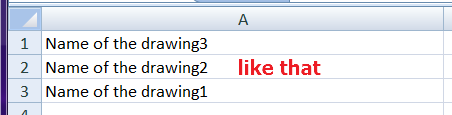

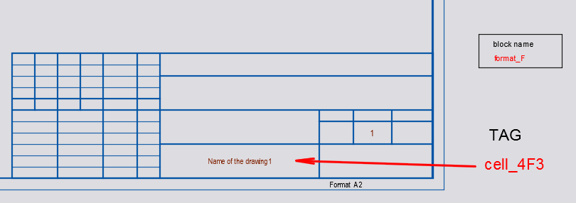

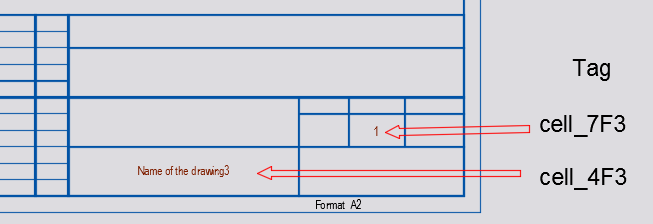

Nikon Posted August 31, 2024 Posted August 31, 2024 (edited) I need to select blocks with the same names but with different attributes /tag: cell_4 F3/ (the name of the drawing) and get a list of only these attributes without a tag. for example: Name of the drawing1 Name of the drawing2 Name of the drawing3 ;; Lee Mac / February 21, 2010 (defun c:BlockOut (/ *error* lst2str FILE IATT IBLK INFO OFILE SS) (vl-load-com) (defun *error* (msg) (and ofile (close ofile)) (or (wcmatch (strcase msg) "*BREAK,*CANCEL*,*EXIT*") (princ (strcat "\n** Error: " msg " **"))) (princ)) (defun lst2str (lst del) (if (cdr lst) (strcat (car lst) del (lst2str (cdr lst) del)) (car lst))) (if (and (ssget '((0 . "INSERT"))) (setq file (getfiled "Output File" "" "csv" 1))) (progn (vlax-for obj (setq ss (vla-get-ActiveSelectionSet (vla-get-ActiveDocument (vlax-get-acad-object)))) (setq iBlk (list (if (vlax-property-available-p obj 'EffectiveName) (vla-get-EffectiveName obj) (vla-get-Name obj)) (vla-get-Handle obj))) (if (eq :vlax-true (vla-get-HasAttributes obj)) (foreach att (vlax-invoke obj 'GetAttributes) (setq iAtt (cons (list (vla-get-TagString att) (vla-get-Handle att) (vla-get-TextString att)) iAtt)))) (setq Info (cons (cons iBlk iAtt) Info) iBlk nil iAtt nil)) (vla-delete ss) (setq ofile (open file "w")) (foreach b Info (write-line (lst2str (car b) ",") ofile) (foreach a (cdr b) (write-line (lst2str a ",") ofile)) (write-line "" ofile)) (setq ofile (close ofile)))) (princ)) Format_F.dwg Edited September 10, 2024 by Nikon Quote

Nikon Posted September 3, 2024 Author Posted September 3, 2024 (edited) 12 hours ago, BIGAL said: Ok I understand what your trying to do, I was getting confused by you using the words drawing 1, when you mean "layout 1". Mr. BIGAL, Thank you for your participation. Sorry for my English... I don't mean the layout. Let's assume that there are no layouts. I'm in the model space. I use lisp Lee Mac "BlockOut" and I get the file Microsoft Office Excel (.csv) with tags and attributes. BUT I only want to get the attributes: Name of the drawing1 Name of the drawing2 Name of the drawing3 Edited September 3, 2024 by Nikon Quote

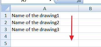

Nikon Posted September 8, 2024 Author Posted September 8, 2024 (edited) Mr. @BIGAL thank you, unfortunately the attributes are arranged in a random order. in Excel Name of the drawing1 Name of the drawing2 Name of the drawing3 Name of the drawing4 And in the drawing they are arranged like this (from top to bottom): Name of the drawing3 Name of the drawing2 Name of the drawing4 Name of the drawing1 in Excel The first drawing The fourth drawing The second drawing The third drawing And in the drawing they are arranged like this (from top to bottom): The first drawing The second drawing The third drawing The fourth drawing In the real project, the attributes are again arranged in random order... Perhaps it would be easier to add a second attribute CELL_7F3 (sheet number) and arrange the attributes (CELL_4 F3 and CELL_7F3) in order by these numbers? Edited September 8, 2024 by Nikon Quote
BIGAL Posted September 9, 2024 Posted September 9, 2024 (edited) The easiest answer is to use layouts then you process in layout order. As part of making layouts you draw a rectang at desired scale around objects then layouts are made automatically based on the rectang. Each layout has the title block at 1:1 scale ie true size like A2 but the mview reflects the objects at desired scale. Remove the line (setq lst (BubbleSort lst)) from the code. when asked to select titles pick them one at a time in the order you want and it should work. The issue with do in view order is what about using horizontal titles, a grid of titles, random placement of titles. Yes adding a extra attribute is one way around the problem. But for me use layouts. You will not look back. Edited September 9, 2024 by BIGAL 1 Quote
Nikon Posted September 9, 2024 Author Posted September 9, 2024 6 hours ago, BIGAL said: The easiest answer is to use layouts then you process in layout order. As part of making layouts you draw a rectang at desired scale around objects then layouts are made automatically based on the rectang. Each layout has the title block at 1:1 scale ie true size like A2 but the mview reflects the objects at desired scale. Remove the line (setq lst (BubbleSort lst)) from the code. when asked to select titles pick them one at a time in the order you want and it should work. )) from the code. when asked to select titles pick them one at a time in the order you want and it should work. The issue with do in view order is what about using horizontal titles, a grid of titles, random placement of titles. Yes adding a extra attribute is one way around the problem. But for me use layouts. You will not look back. Mr. @BIGAL Thank you sincerely! "Remove the line (setq lst (BubbleSort lst))" - this action helped! And I will definitely take your advice... Quote
