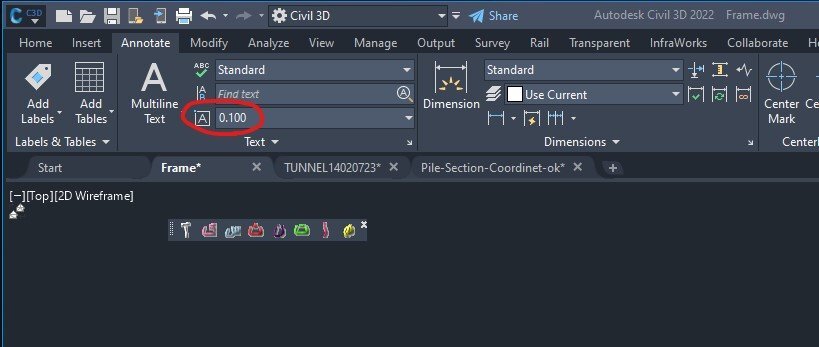

How can I replace this number in the photo with a lisp? Can someone write lispy for me?
You need just to type "TEXTSIZE" in command prompt and put the number wish you want.
Edited by Saxlle

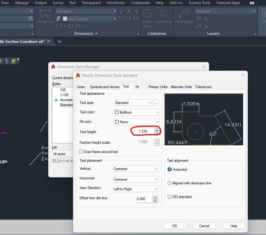

thank you I apologize. I asked the wrong question. I want to change the following number by a lisp. please help
Is this a change for all text created in the drawing or for a single piece of text?
all text
Can you post a .dwg where you want to modify text height in model space?
might be
(setvar 'textsize -newtextheightasnumber-)
"all text" but image is change dimension text height. TEXT & Dimension Text are 2 different objects. Changing 'textsize does not change dims if style is set with a non zero height. Same with Text.
Post a dwg.
Edited by BIGAL
For Dimension Text, Type DIMTXT, then enter the size you want. Again - no Lisp solution needed.
Edited by pkenewell
After DIMTXT is set, you need to use -DIMSTYLE>APPLY, then for select type ALL then ENTER,  to update the dimension(s).
A LISP or Script would be handy if needing to do a lot of drawings.
P.S. DIMTXT is a System Variable (Sysvar) = (SETVAR "DIMTXT" 2)
Something like this...

If you DON'T want it to apply the change to all the dimensions with that style, use the DIMOVERRIDE command to change selected dimensions. Here is a tool that I use to create quick Dimension override commands:
