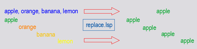

Nikon Posted August 31, 2024 Posted August 31, 2024 (edited) Suppose that there are discrete texts in different places of the layout, for example, apple, orange, banana, lemon. I need a lisp that after typing the command, I do the first right click on the apple, and by doing the rest of the right clicks on other fruits, they turn into apples. Lisp will replace any number of selected texts with "apple" (for example)... First, select the replacement texts, and then specify the sample text. replace.lsp Edited August 31, 2024 by Nikon 1 Quote
