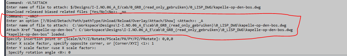

I'm trying use Vault commands in my lisp routine, specifically the "-vltattach".
But I'm running into an issue that I don't quite know how to fix.
Here's the relevant snippet of code from my routine:
(setq ip (list 0 0 0))
(command "-vltattach" fullpad "_no" ip 1 "" 0)
"Fullpad" is a variable that has the filepath stored in it and "ip" is a variable with the insertion point.
The command can find and load the file from the Vault fine, but then it seems to not want to accept any input for the insertion point.
Does anyone have an idea as to what the problem could be and how to fix it?

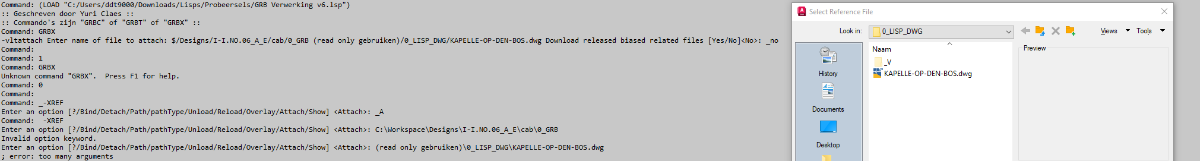

This is what the command line looks like:
To me that looks like it can find the file just fine, but after it finds the file it goes into the -xref command. But I've got no clue as to why it does that.

I've also noticed that the small part of code after the "-vltattach" command gets executed after the command accepts the "_no" input but before it jumps into the "xref" part I mentioned before.

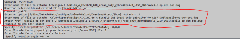

If I run '-vltattach' from the command line. These are the things I have to enter (see image):
The part I circled in red is something I don't do myself. AutoCAD does that on its own and after that I can enter the rest of the stuff.
I assume that's the reason it breaks in Autolisp?
-vltattach only needs the first 2 inputs and then it switches to -xref (in some way) for all the other inputs?
Looking at the above -vltattach downloads the file locally but after that is done plain _.-xref might work?

No idea. I don't type the '_A'. The command just chooses that.
After I've entered "_no" the next thing I can enter is the insertion point.
Everything between that is not done by me.
That's what I was thinking, but I can't seem to figure out how to stop the -vltattach command after it's downloaded the file.
It just seems to transition into the -xref command by itself but that then seems to interfere with giving it the inputs for anything after that.
