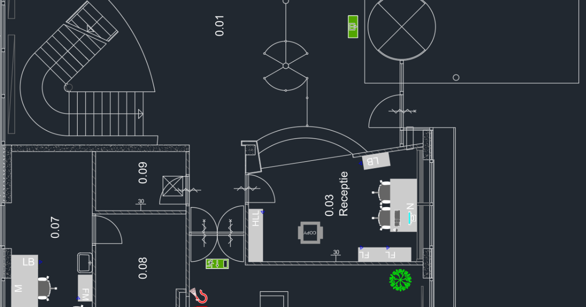

I have a excisting building drawing with several areas being numbered and named. Now i want to create a list of the room names and the corresponding number in a Excel list.
My idea was to just type over from the drawing but i already noticed that not all areas are named and/or numbered. Also i noticed that the numbers dont make sense.
So the first room number starts with 0.01 and the last is 0.91 but there are not that many rooms so im missing like 30 numbers.
My question is if there is a list of those numbers and names you can pull out from CAD, so i can see if there is some kind of logic to the numbering.

I just wanna figure out if there is a index list of room numbers in CAD that can be edited so it automaticly adjust it on the drawing or if the numbers and names have to be edited one by one on the drawing.

Impossible for me tell, wouldn't that have to be in the .dwg?
Titleblocks, names and addresses can be removed.
Use wblock so just get a sample portion of the dwg from "Model"
Looking at image almost easier to just redo the numbers and names say "Reception" & "1". There is a few ways to speed up select room name if there is not to many names.
