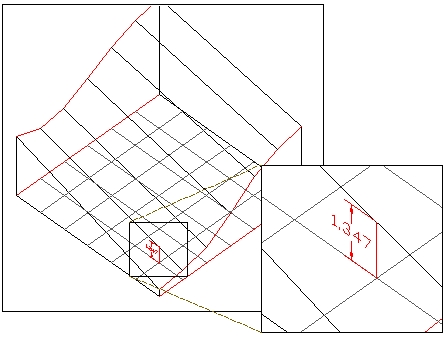

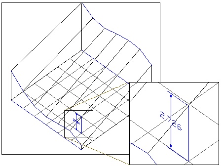

SEANT Posted April 2, 2009 Posted April 2, 2009 I’m not sure how possible it is to create the “Coons” solid with Union, Subtraction, and Intersection. Though, it is an interesting concept to consider. With regard to Solids, it may be possible to address it via a regular grid, processed point by point. This may give the necessary Slice points for a solid extruded from each grid section. See Sample. Granted, this is rather labor intensive. The process would certainly benefit from some type of automation. It would likely be a pretty complex routine, however. Coons.dwg Quote

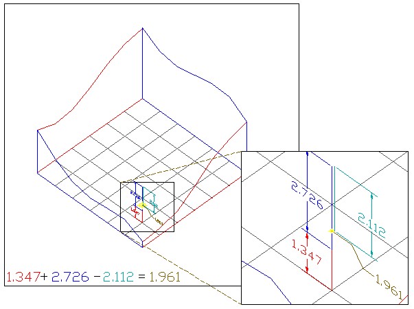

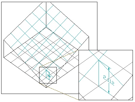

SEANT Posted April 4, 2009 Posted April 4, 2009 So you’re addressing it at various intervals as well. I think the only difference between your technique and the one I’m proposing is the type of operations. You’re starting with the average of the spans A and B. My method is adding A and B, then subtracting C to generate the position D. Quote
Bella_Ciolla Posted April 4, 2009 Author Posted April 4, 2009 WOW thank you Seant I really appreciate that illustration, that really helps me understand it alot better. Now that were both looking at the same thing, would you say the boundary curves would have to always be along the end points? Know what I mean? When i see © connecting to the boundary points, it wouldn't always take into account a curve that might taper out against the boundary. I mean would the line have to be 90 degrees straight from the bilinear patch? Another thing is what if the lofts lines are not directly above the bilinear patch? Your illustrations make perfect sense to me, but they dont explain what you would do if the loft lines weren't directly adjacent to the bilinear patch Quote
