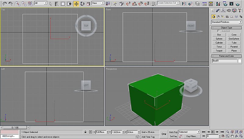

since a few days my gizmo has "disipeard" in max
i can still rotate, move, scale but only in the direction of the view
so when im in top view i can only move within the xy axis
im finding it realy anoing, i have reinstalled max, but didn't change
can someone tell me what i did wrong?
i attatched a picture where u can see that my move tool is on but cant see the gizmo
Thx anyway
Jason
Reinstall should only be used as a last resort. Your problem is a simple one. Just hit X on your keyboard. X toggles your Gizmo display on and off.
thx very much
need to learn some more hotkeys
Jason
