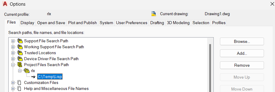

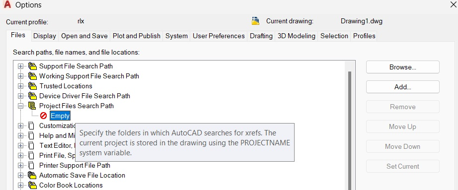

I am leaning towards this by rlx
I'm not sure if images behave the same as xrefs but maybe its possible to strip out path completely and use Bigal's suggestion to add path to support path?
With xrefs you have something like (setvar "projectname" "MyProjectName") and by adding alternative path(s?) to this variable you can make AutoCad also search there.
At my work we don't work with images so I would have to experiment but if it works you would only have to change path in variable 'projectname and you're back on the road.
