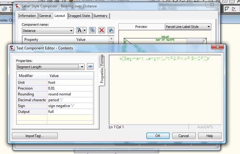

Make sure you're looking at the parcel > line label style. Look for "contents" under Text. Click it, then the little cute gray box with three dots. In there you can click the line length field on the right and it will tell you on the left what the properties of it are including the units.
This is what it is showing. My instructor this quater is not the best. Good guy just has no idea about Civil drafting not really sure if he has any CAD knowledge. Also could it be when i put in the lines i have to put the foot symbol in to get it an actuall foot. But if I put the dim in with out that it draws it to inces but labels it as foot.
