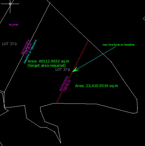

Hi All,
I have just finished writing the LISP as shown below, and am currently testing it.
I keep receiving a temperamental Error Message that will sometimes show and at other times the LISP will complete successfully.
But I can't for the life of me work out what is going wrong sometimes.
Any help is much appreciated - and I thank you for your time.

Use (if(not(vlax-erased-p tPoly)) to will be convinced that your polyline isn't erased or use (setq tPoly nil) after (vla-Delete tPoly).
Usage of (vla-Delete tPoly) will not change tPoly variable value.
Ahh good point!
I suppose, as its an iterative process - there is a chance that the area will not be found within the Tolerance (Acc) - but as tPoly is not set to nil, the LISP will still try to proceed...
Many thanks ASMI - will give that a go :)
Cheers
Lee
Found a few other glitches, like the areas being labelled the wrong way round, but all seems to be fixed now :)
It sometimes can't partition the region, I think because (being an iterative process), the area doesnt come to within the tolerance set before the loop gets to the end of the curve - but decreasing the incremental step will only slow the program down. :(
But anyway, here is a final result:

I’ve been watching this and the related thread but have not been able to add much due to limited Lisp experience. I can certainly see the complexity of the situation, however.
After further pondering, I’d be interested to know how the process would deal with the situation illustrated here, and in simplified form below.
In the “simplified”, there seems to be a discontinuity in a target area from 60 and 64 square units.
Yes, I had that on my mind too Sean, I am finding the intersection between a line parallel to one of the edges of the original region, and the region itself - but I only use the first two intersections, hence only focussing on shapes that aren't concave at any point (if that makes sense).
I suppose I could add a bit of code that says something like, "if the intersection list is greater than two, then ignore vertices between every other point, but then this still would become complicated for more complex shapes. :(
I guess this is a good example of how programs can continue increasing in complexity to account for situations that are increasingly unlikely to occur. A line has to be drawn somewhere, as they say. Nice routine.
Cheers Sean, I agree - I could go on all day with this one, trying to think up more and more complex shapes to test it on - I suppose you could also include a quick test to find all self-intersections, so that you can't test on objects that intersect themselves.
