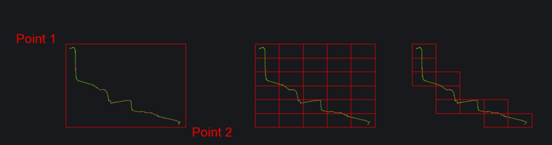

(setq pt1 (getpoint "\nPick top left point ") pt2 (getcorner pt1 "\nPick bottom right"))
As I suggested previously then round down and up the corner points a given tolerance this gives 1st and last sheet a small tolerance say 50. Not sure why but the 1st rectang was not at the X value of extmin, tested on a random dwg.
I use Bricscad V24 and had to redo the Command "rectang" just one of those subtle differences.
(command "_.rectang" "_dim" 1000 500 "_none" (car l_ext) "_none" (cadr l_ext))
Can see in this image outline is min & max the blue blocks are not in line with the rectang maybe need a -ve to rect corner for X.
Just a comment earlier versions of Bricscad need to have express tools downloaded.
Just another way to make the rectangs, rounds down and up to 10 interval.
(command "snap" off)
(setvar 'osmode 0)
(setq pt1 (getpoint "\nPick top left ")
pt2 (getcorner pt1 "\nPick bottom right ")
(setq x1 (car pt1) y1 (cadr pt1))
(setq x2 (car pt2) y2 (cadr pt2))
(setq x1 (- (* (fix (/ x1 10.0)) 10.0) 10.0))
(setq y1 (+ (* (fix (/ y1 10.0)) 10.0) 10.0))
(setq x2 (+ (* (fix (/ x2 10.0)) 10.0) 10.0))
(setq y2 (- (* (fix (/ y2 10.0)) 10.0) 10.0))
(setq pt1 (list x1 y1))
(setq pt2 (list x2 y2))
(setq d1 (fix (+ (/ (- (car pt2)(car pt1)) 1000.) 1)))
(setq d2 (fix (+ (/ (- (cadr pt1)(cadr pt2)) 500.) 1)))
(setvar "CLAYER" "(TopografieGBKN) Sluitlijn")
(command "_.rectang" pt1 (mapcar '+ pt1 (list 1000.0 -500.0 0.0)))
(command "_.array" (entlast) "" "_rectangular" "columns" d2 "rows" d1 -500 1000)

I use AutoCad and Tsuky's code seemes to work great most of the time. I have a few instances where it does go wrong.
I added the examples g1965745 and g1955750 where the polyline goes outside of the rectangle 'box'.
Any idea why this happens sometimes?
Revisie test.dwg g1965745.dwg g1955750.dwg
