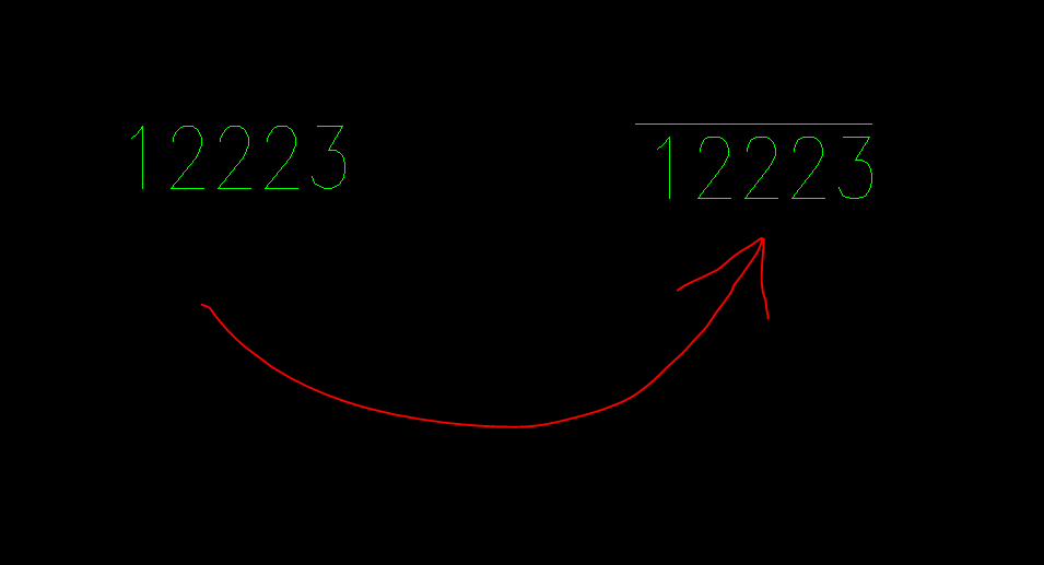

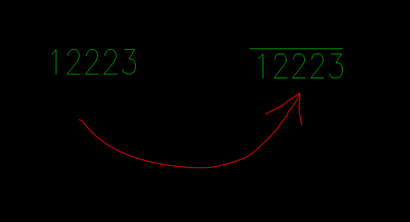

leonucadomi Posted August 8 Share Posted August 8 Hi, I would like to know if you know of any routine that can be used to select a group of texts or mtext and put a line above them. any comment is welcomed Quote Link to comment Share on other sites More sharing options...
ronjonp Posted August 8 Share Posted August 8 Try this: (defun c:foo (/ o s) (if (setq s (ssget ":L" '((0 . "*TEXT")))) (foreach e (vl-remove-if 'listp (mapcar 'cadr (ssnamex s))) (setq o (vlax-ename->vla-object e)) (if (= "TEXT" (cdr (assoc 0 (entget e)))) (vla-put-textstring o (strcat "%%O" (vl-string-left-trim "%%O" (vla-get-textstring o)))) (vla-put-textstring o (strcat "\\O" (vl-string-left-trim "\\O" (vla-get-textstring o)))) ) ) ) (princ) ) 2 1 Quote Link to comment Share on other sites More sharing options...
