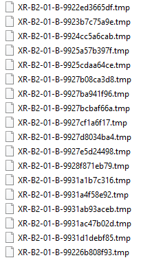

Hello guys, I have one CAD file saved in specific folder. I just noticed in the same folder I have bunch of tmp files, and keeps on adding the files. Is there any settings on my Autocad needs to change? Thanks in advance.  See screenshot below.
"*.tmp files contain information that is used by various AutoCAD commands (such as UNDO) and do not contain any drawing data that can be recovered. They should only exist during an AutoCAD session but may be left behind if AutoCAD crashes or is abnormally terminated."
This may be helpful it looks into your temp directory and allows you to delete files left behind you may be horrified the first time you run it as to how many exist.
I have reset my temp file to a simpler location so often clean it up. You will need to save Multi toggles.lsp in a support directory.
If the tmp files are there add to the code their name. Adding LST8 that looks at (getvar 'dwgprefix) so checks for current dwg.
