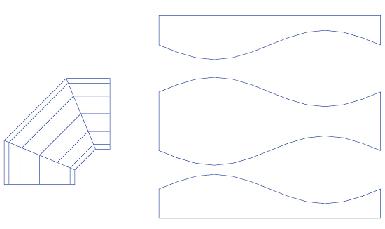

Buggsy Posted May 29, 2011 Posted May 29, 2011 How do I make this file to opt out of the pattern that is drawn off to the right side? The DU.lsp file in this post Quote
mdbdesign Posted May 29, 2011 Author Posted May 29, 2011 DU.lsp was made by Fixo to meet specific request and is working great. This pattern is for pipe cut layout when you plan to do your elbow out of pipe segments. Just delete when you don't need it. Quote
Buggsy Posted May 29, 2011 Posted May 29, 2011 Thanks for the reply, yes the file works great. It draws what is called gore elbows for heavy sheetmetal ducting. The pattern off to the right is called a flat pattern for layout of flat sheetmetal. Once cut, the pieces can be rolled to proper diameter in preperation of weld assembly. Then the pieces can be welded together as an assembly to complete the elbow. I understand all of this and what the file is doing. I've been doing ductwork for 13 years now, but I'm STUPID with lisp files. Can someone explain how to modify this file for an option to OPT out of the pattern part so that I don't have to erase the pattern everytime I use the file? Quote
mdbdesign Posted May 29, 2011 Author Posted May 29, 2011 (edited) Try "du1.lsp". You can compare what was deleted form "du.lsp" For flat pattern I use perfectly working "Litio v2.0.5" add-in for Autocad. What program do you use or you still in manual? DU1.LSPFetching info... Edited May 29, 2011 by mdbdesign too fast finger Quote
