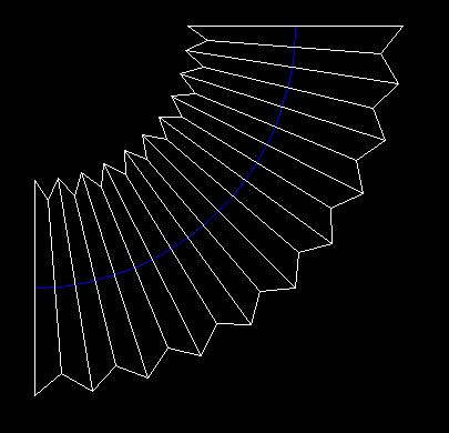

We got large project for aluminum duct system ranging Ø from 100 to 1000 mm involving lots of elbows My question is: is there somewhere lisp that can draw side view of elbow with only user input as: duct OD, # of segments and elbow degree.
Please help:)

Try this for starters:

My apologies, this is better:

Not restrictions, I just thought you wanted ducting like this:
Ok, I've given you an "adjustment menu" at the top of the LISP, play around with it til your hearts content :)
