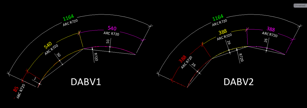

I was intrigued by this requested - and wanted to test ChatGPTs LISP and math prowess (not sure if allowed - and apologies if this is an insult to the resident LISP gurus!).  Results might be useful, but I was impressed it was able to get this far.  It took 9 attempts to arrive at this code
2 routines below:
DABV1 - divides an ARC into lengths according to specified versine, with a 'remainder' arc
DBAV2 - creates equal arc lengths up to maximum of specified versine

You could look at something like this that asks for number of chords, you would use say radius values to set how many. In Civil works there are no curved breaklines so a work around is to ask for the max versine value and work back from that. May be the way to go with rather than looking at a radius.

Nice BigAl.  I frequently use a similar routine for those types of exercises - Lee Mac's SEGS
I use it instead of the native DIVIDE
