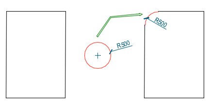

Nikon Posted August 1, 2024 Posted August 1, 2024 There is a program Kent Cooper, but unfortunately it doesn't work. I choose a circle (or an arc). It ends with an error... Please tell me where the error is. (defun C:FMR (/ aper pt); = Fillet Match Radius [of existing curve] ; to apply the radius of a selected curved object in the Fillet command ; Kent Cooper, June 2011 (setq aper (getvar 'aperture)) (while (not (setq pt (cadr (entsel "Select curve to set Fillet Radius: ")))) (prompt "\nNothing selected -- ") ); end while (setvar 'aperture (getvar 'pickbox)); ensures Osnap won't "see" wrong thing (if (osnap pt "cen") (setvar 'filletrad (distance (osnap pt "nea") (osnap pt "cen"))); then (progn ; else (prompt "\nNo radius for that object.") (setvar 'aperture aper) (exit) ); end progn ); end if (setvar 'aperture aper) (command "_.fillet" "_mUltiple") (princ) ) ; Select curve to set Fillet Radius: ; No radius for that object.; error: end/exit abort Quote

Nikon Posted August 2, 2024 Author Posted August 2, 2024 (edited) 38 minutes ago, Tsuky said: And if you internationalize the parameters of (osnap) "cen" -> "_cen" "near" -> "_near" This might work! ; by Kent Cooper (defun C:FMR (/ aper pt); = Fillet Match Radius [of existing curve] ; to apply the radius of a selected curved object in the Fillet command ; Kent Cooper, June 2011 (setq aper (getvar 'aperture)) (while (not (setq pt (cadr (entsel "Select curve to set Fillet Radius: ")))) (prompt "\nNothing selected -- ") ); end while ;(setq obj (car (entsel "\nSelect circle:"))) ;(setvar 'filletrad (cdr(assoc 40 (entget obj)))) (setvar 'aperture (getvar 'pickbox)); ensures Osnap won't "see" wrong thing (if (osnap pt "_cen") (setvar 'filletrad (distance (osnap pt "_nea") (osnap pt "_cen"))); then (progn ; else (prompt "\nNo radius for that object.") (setvar 'aperture aper) (exit) ); end progn ); end if (setvar 'aperture aper) (command "_.fillet" "_mUltiple") (princ) ) Now this code is working! @Tsuky THANK YOU VERY MUCH! "set_fillet" works very well! Edited August 2, 2024 by Nikon Quote
