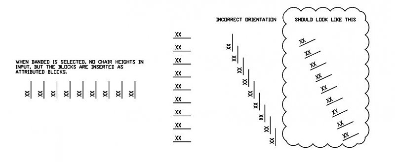

Maybe I am looking at this the wrong way... If you look at the picture I have uploaded. You can see that my inserted drawings (they are called chairs) are inserted across the line that was selected by using GetPoint. So if the line is from 12 o-clock to 6 o-clock then the chairs are inserted 90 degrees evenly spaced out. If the line was left to right then the chairs are inserted 0 degrees.
At least that's how I understood it until this week. Now they want it to follow the figure on the far right. That's why I was trying to figure out the degrees.
I think I am looking at this the wrong way. Any comments would be very helpful.

I think what your doing wrong is calculating the angle sort of backwards Autocad measures angles counter clockwise in Radians and takes no notice of what your units settings are when you write code so sometimes you even need to know which quadrant your in to either add 90deg or subtract so the block does not appear upside down. Also make sure your in world UCS.
For your Block you would add 1.5714 to the angle of the line should work then adjust upside down.

yep, your right, I need to flip 90
Now time to read about quadrants!!!
1.5714 is the magic number!!!! thanks to all.
Recap...
Used the AngleFromXAxis function
and then added 1.5714
and converted my Generic InsertBlock function to use rads
