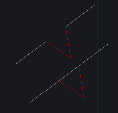

Would it be possible to create a gap or split on 3d polyline by implementing  nentsel-getreal and gr-osmode in the code ?
For example I have 3d polyline and I just want to select two points on 3d polyline to create a gap? Maybe instead of gap, line could still stay if needed?
Thank you for your help

Line Osnap nearest so pick a point, drag a line from that point, Line Osnap nearest draw second line. Trim, pick the dummy 2 lines Enter pick between them and section is trimmed out.
A lisp yes but pretty quick to do manual only thing is lisp deletes dummy lines.

Looks good, but would need lisp code expertise to help.
yes i knew that, but i am looking for lisp possibility.

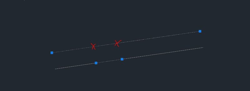

With this?

(defun c:partial_cut ( / ss ent vlaobj pt_brk pt_brk2 tmp_brk new_ent e_last)
  (vl-load-com)
  (princ "\nSelect a curve object.")
  (while
    (not
      (setq ss
        (ssget "_+.:E:S"
          (list
            (cons -4 "<AND")
              (cons 0 "*POLYLINE,LINE,ARC")
              (cons -4 "<NOT")
                (cons -4 "&") (cons 70 112)
              (cons -4 "NOT>")
            (cons -4 "AND>")
  (redraw (setq ent (ssname ss 0)) 3)
  (setq
    vlaobj (vlax-ename->vla-object ent)
  (initget 1)
  (while
    (or
      (equal (setq pt_brk (vlax-curve-getClosestPointToProjection vlaobj (trans (getpoint "\nGive the first point: ") 1 0) '(0.0 0.0 1.0))) (vlax-curve-getStartPoint vlaobj) 1E-13)
      (equal pt_brk (vlax-curve-getEndPoint vlaobj) 1E-13)
    (initget 1)
  (cond
    (pt_brk
      (draw_pt (trans pt_brk 0 1) 3)
      (initget 1)
      (while
        (or
          (equal (setq pt_brk2 (vlax-curve-getClosestPointToProjection vlaobj (trans (getpoint "\nGive the second point: ") 1 0) '(0.0 0.0 1.0))) (vlax-curve-getStartPoint vlaobj) 1E-13)
          (equal pt_brk2 (vlax-curve-getEndPoint vlaobj) 1E-13)
        (initget 1)
      (if pt_brk2
          (command "_.undo" "_begin")
          (draw_pt (trans pt_brk2 0 1) 3)
          (if (> (vlax-curve-getParamAtPoint vlaobj pt_brk) (vlax-curve-getParamAtPoint vlaobj pt_brk2))
            (setq tmp_brk pt_brk2 pt_brk2 pt_brk pt_brk tmp_brk)
          (command "_.break" (cons ent (list (trans pt_brk 0 1))) "_first" "_none" (trans pt_brk 0 1) "_none" (trans pt_brk 0 1))
          (setq new_ent (entlast))
          (command "_.break" (cons new_ent (list (trans pt_brk2 0 1))) "_first" "_none" (trans pt_brk2 0 1) "_none" (trans pt_brk2 0 1))
          (setq e_last (entlast))
          (entdel e_last)
          (entdel e_last)
          (sssetfirst nil (ssadd new_ent (ssadd)))
          (initget "Yes No")
          (if (eq (getkword "\nErase it? [Yes/No] <No>: ") "Yes")
            (progn (sssetfirst nil nil) (entdel new_ent))
          (command "_.undo" "_end")
          (redraw)
  (redraw ent 4)
  (prin1)

Thank you Tsuky, top quality as always!
