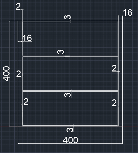

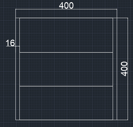

I created this little autolisp code:
But the result of my code is what you see in the first image and I need the result to be like the 2nd image.

This is 1100 lines of code. But does multiple window panels. Your request would be a lot less code.
You are well on your way to draw what you want, it is a case of looking at what is being output now, like the draw horizontal lines wanting to be 3mm and vertical 2mm. When I do something like this I get a sheet of paper and write on it point numbers say top drawer, would be p10 p11 p12 p13, so an internal offset would be worked out a new rectang drawn with p10a p12a no line would be drawn. I work with points rather than just getting say a rectang 2 corners.
It is a  task to change the code to look like what you want, in the code above is a defun that draws rectangs (rec pt len ht) it would be used a lot in your task.
It may be possible to use what you have. If you pick inside the drawer and use Bpoly it will return a pline you can then get the co-ordinates of that bpoly and use that to draw a new rectang. As you want 3 drawers more or less would need to make a list of the selected points 1st. So repeat for each drawer.

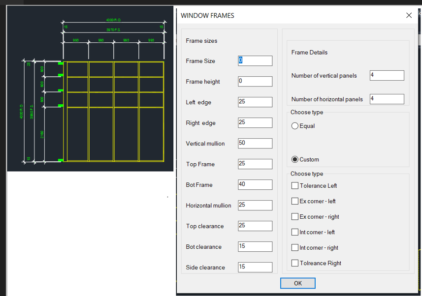

I have attached a lisp that will do a dcl for you including default values, for all your input, look at the examples in the top of the code. You will need to read the list of values which are returned as a string into a number. eg
(setq width (atof (nth 0 ans))
(setq  num_drawers (atoi (nth 8 ans)))
So make a start there is plenty here that could help, or you could be lucky and some one has what you want.

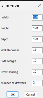

(if (not AH:getvalsm)(load "Multi Getvals.lsp"))
(setq ans (AH:getvalsm (list "Enter values " " Width " 5 4 "400" "height " 5 4 "400" "Depth " 5 4 "400"
"Wall thickness " 5 4 "18" "Side Margin" 5 4 "10" "Draw spacing" 5 4 "10" "Number of drawers" 5 4 "2")))
Multi GETVALS.lsp
