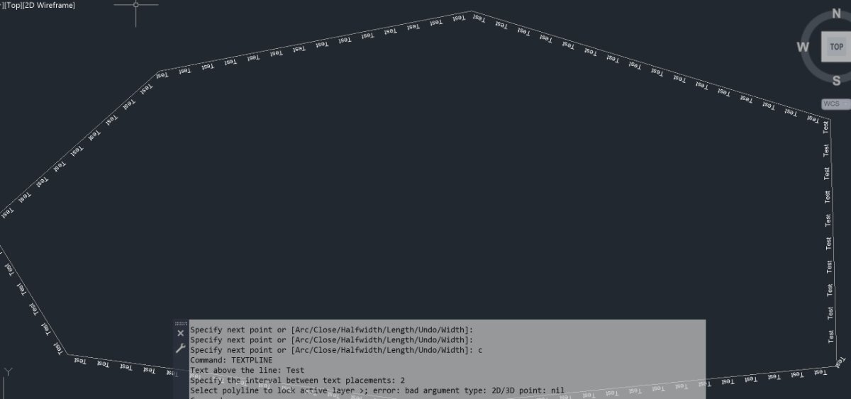

Hi
Could someone help me to tweak this lisp code so text appear outside the polyline and become readable, please?
Thank you!

What your missing maybe, "is pline CW or CCW, can reverse pline then text will always go out.
