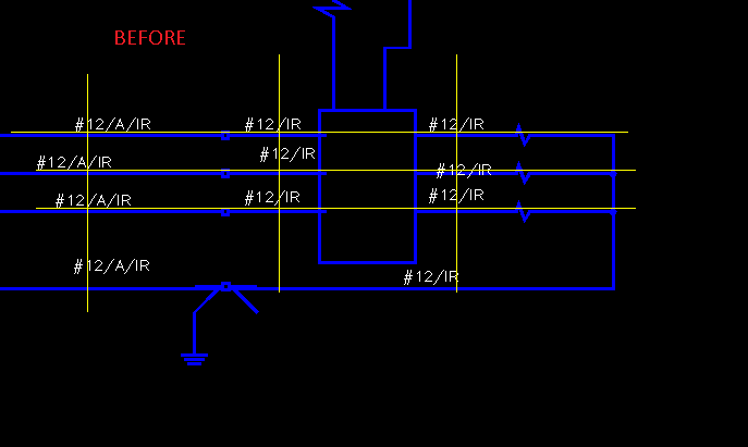

Looking for a code to line up Mtext/Text sometimes vertical and sometimes horizontal and sometimes set the justification.
Also I need to set Mtext defined width 0 (or just reduce it to the longest row or Text is fine ,but, if I explode the Mtext, it doesn't maintain the Justification.
P.S. I have Joe Burke's ShrinkwrapMText v2a.lsp, but I get (error: bad argument type: lentityp nil), I haven't looked into debugging it yet.
I also have MtextColumnsOffZeroWidth.lsp by BlackBox that I haven't tried yet.
I am more in need of aligning things.
In the example, I have already aligned manually some of the mtext, but manually is taking a while.
These started as scanned PDFs, I am converting the raster text with Raster Design and tracing the plines. When converting the raster text the locations are not accurate and though you can set justification the options are Left, Center and Right, which defaults to TOP and when I do a drawing I like to make them neat and align as much text as possible.
In case you are wondering, these are electrical diagrams and all in Modelspace.

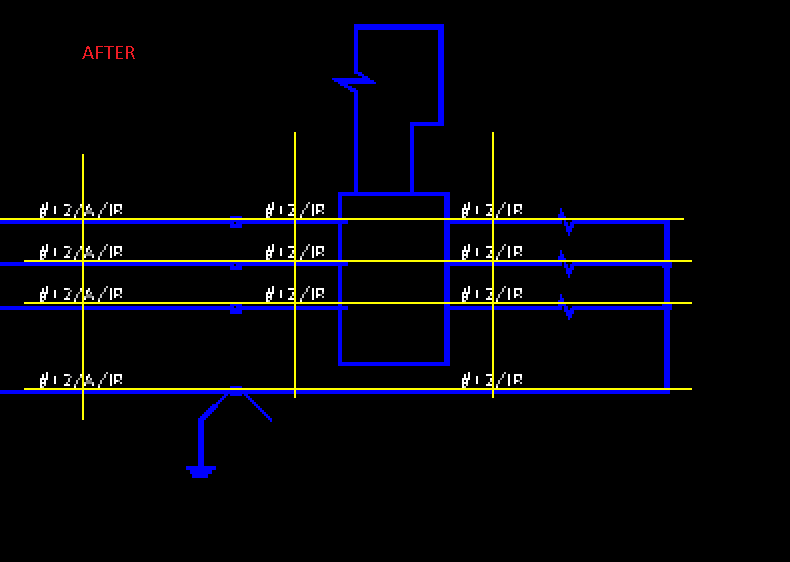

I need most of the text aligned with (but not on) the nearest line (wire) unless an object forces it off more than the others.
I'll check those out shortly, but you appear to have the right idea. The red and yellow lines in the drawing are to show alignment point, I am trying to eliminate making lines everywhere to align with. I would just like to be able to click a start text/Mtext and align them and match justification with the first text.
The command TextAlign is working well enough for now for aligning, I just have to set Justification correctly as I create the text, then when I go to align select the alignment justification.

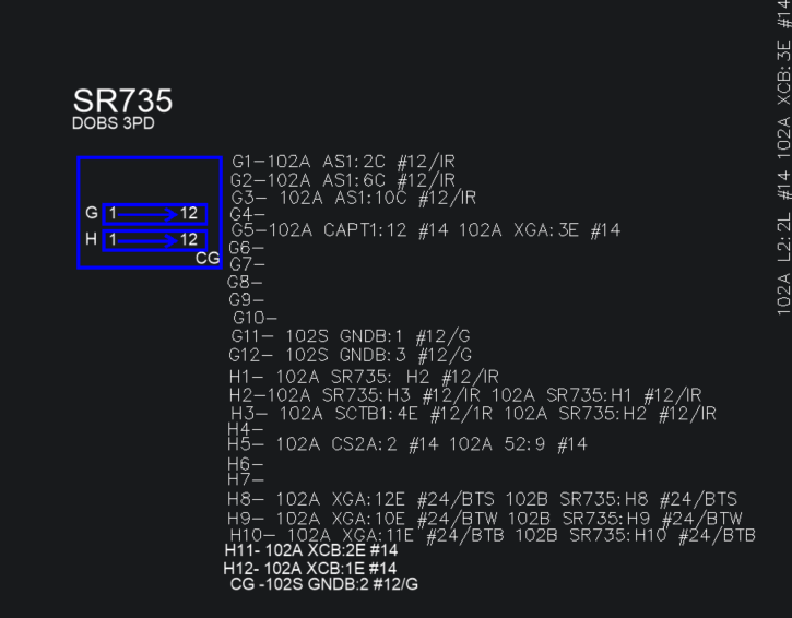

Looking to speed up TEXTALIGN command at a minimum. It's pretty clunky if you have lots of aligning to do of different justifications. Help | TEXTALIGN (Command) |
So basically, Select Texts/Mtexts to be aligned, Select the Text/Mtext to match justification and to align with and/or select the desired justification, then with mouse or quickly choose horizontal or vertical (I can manage without the oblique).
Raster Design OLE can set justification, Left ,Right, Center, but,  they are all set to TOP, I just have to select it each time, you can also select the text height or automatic, which is random.
I also use a lot of MatchProp, but it moves the text, sometimes a lot. As long as visually everything appears aligned, I'm good with that.
Either scanning of the PDFs or originally created, on some of the sheets the texts weren't aligned very well, IMO.
Would it be of use to supply the raster file, I use TIFF? I'll need to scrub confidential information, but it's doable.

I included the TIFF so you can see the image I am working on.
Text Align Test - Standard.zip
Picked an easy group for this video. The while means can keep going.
Can see why the justification is a problem, mid top v's mid bot.
Changed a few others and works reasonably well, not sure if can be sped up more.

Would be easier all around if Raster Design allowed a full selection of justifications, seems the program has been around quite some time with little improvements.
Should be able to set justification as part of the sequence say adding in Alan Thompson's set alignment. Ie one code.
Did find in my V24 Bricscad no "justifytext" a nuisance. But if using Acad no probs.
Latest version has Alan's code.
Code removed see below
Edited by BIGAL
I'll check it out next week when I get back to work.
That was my thoughts exactly, combine with the align macro LISP.
I realize most people really don't need these options, but if you use Raster Design on a raster text heavy file, the conversions take a while themselves, then organizing text/mtext really lengthens that time more than you think. Lining up 2 or 3 texts take up a lot of time.
If Raster Design would work better, i.e., not having all of the justification options for one and not exactly placing the text/mtext where the raster was.
It is still faster than redoing it all from tracing manually.
I'll have to buy a few beers for several people it seems. I am not sure I could have LISPed this from scratch.
Thanks for your work on this. I have a pressing project to complete Monday, though I might have some time Monday to work on codes and testing for this project.
I am getting "Pick text for alignment reference point Enter to exit ; error: AutoCAD.Application: Incorrect number of elements in SafeArray" for...
(vlax-put obj 'insertionpoint ptn)
I will double check what is posted is Ok.
Found a command TJUST that should work in Acad and Bricscad. If not working Acad use _.justifytext.
(command "TJUST" ss "" "MC")
Found a problem in the while fixed that. Hopefully correct now. Did a little bit of reorganising code also. Just did 3 columns of text worked ok.
