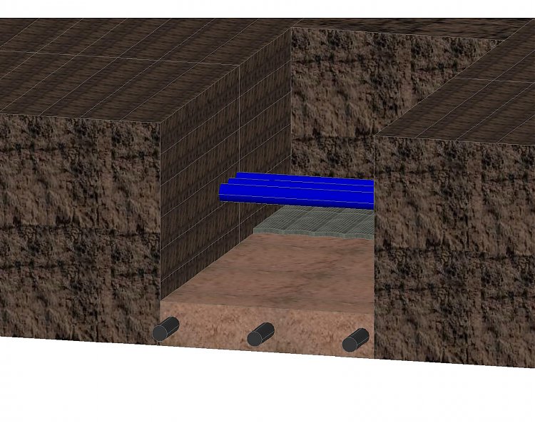

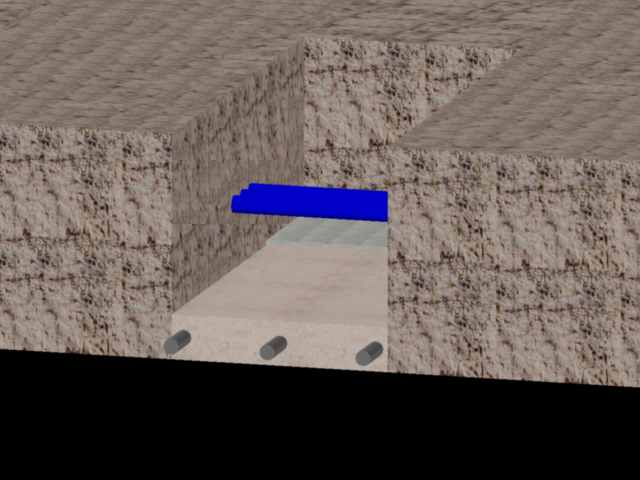

I have a drawing which I have applied a soil material to which I am happy with. The problem is I can see lots of faint lines like you get when you draw a cylinder. When I render the drawing the lines disapear but all the colors go a lot lighter & I get a black background, How I keep the colors the same and remove the lines?
I have atached 2 .jpg so you can see the difference, the lighter of the 2 is the rendered versions
Thank for your help
You should use light sources (eg,sun...).Then you must adjust material
setting depend on your rendering result with lights & shadow !:)
Is there a tutorial on material settings/lights? I have changed the settings in Materials but it does not seem to make much differance. Is there a way of removing the lines without rendering the object?

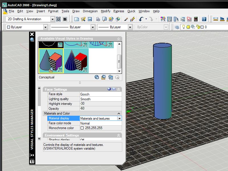

For your request for removing line,first set to "dispsilh" "1".
Then change to conceptual mode & edit to show material according to
my attach image!:)
