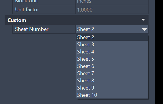

In one of our regular title blocks (dynamic) I get the visibility icon when I select the title block (changes the zones)
I have a legacy drawing with the same functionality but the icon is missing.
If I edit the block the icon is there
I did figure out how to get around this by using Properties
How can I get the icon to appear again?
I cannot upload the drawing unfortunately.
Help please!
Going by my usual cursory research, could it be a nested block with the visibility property contained within the title block? I just created a block with a visibility parameter and then included it in another nondynamic block; the visibility icon went away.
