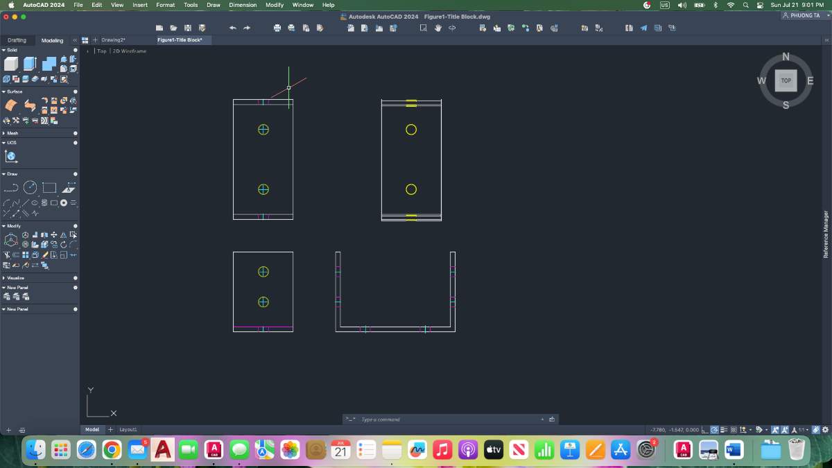

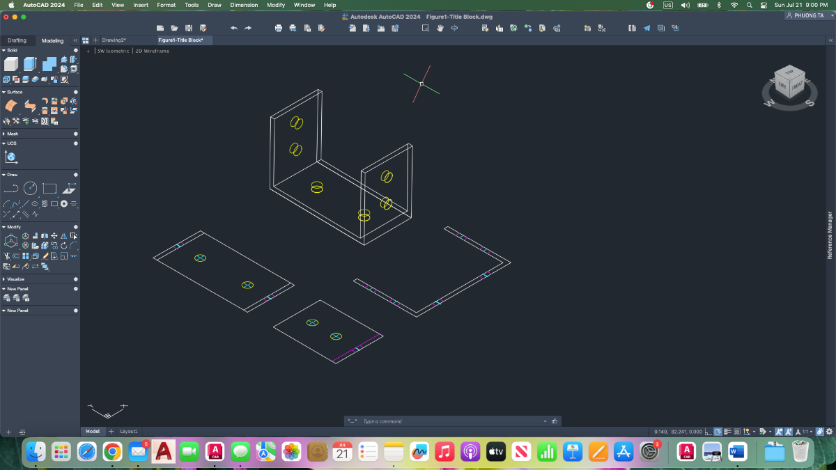

Hi Mark, Could you please take a look at what I have done in the attached screenshot below? I am trying to work on the Rotate3D on the model space Top 2D wireframe, but I am still unsuccessful. Can you instruct me on this point? I appreciate that.
I'm not following you.  The second image shows that you have rotated the view, so the 3D geometry is displayed.
Hi Mark, The second image is shown in isometric view, but when I turn it to the Top 2D wireframe, it does not show the 3D image as the first screenshot. My question is: How can I rotate 3D and view it as required, as shown in the picture below?
Bracket.jpg1.docx
Well first I would switch to an SE isometric view and rotate the 3D bracket 45 degrees to the left.  Then I would reposition my UCS at the lower left-hand corner of the bracket.  At this point it should be obvious which direction the bracket needs to be rotated in order to achieve the desired result.  I never got used to using the ViewCube so I manipulated my UCS via the command line.

If you want true 3d can copy the "U" and extrude it, then use Rotate3d to rotate to correct view angle. But you will need to add the holes. Plan is easy, the sides a bit more complicated as you will need to set the ucs to the side face.
