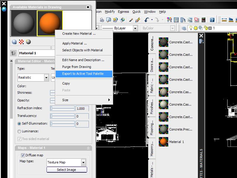

You can create new material with your custom texture.
Then you can add materials to the standard tool palettes
according to attach image!:):)
