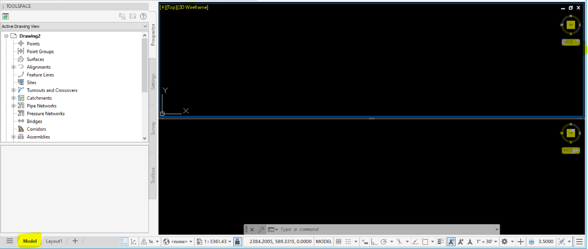

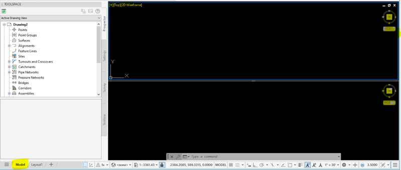

With Two Views in Model, how to apply Zoom Scale to the other
I have two horizontal viewports in model. If I have the bottom zoom scale to whatever it is. How could I apply it to the top view?

Thank you everyone for your ideas. Within Layout Tab / Paperspaces I think your routines work.
When the active view is the top view (model tab), and whatever that zoomscale seems to be. Then click the bottom view and make it the same zoomscale (model tab).
And when you change zoom scale in bottom viewport, it reflects in top one...
So you want to see zooming at both viewports in the same time you are zooming in either one viewport...
But why are you working with 2 viewports in model space in the first place?
Isn't that somewhat cumbersome?
its for civil3d. usually have a profile view in the top view and an alignment in the bottom.
If I were to click on the alignment station, it zooms to the place in profile view.
