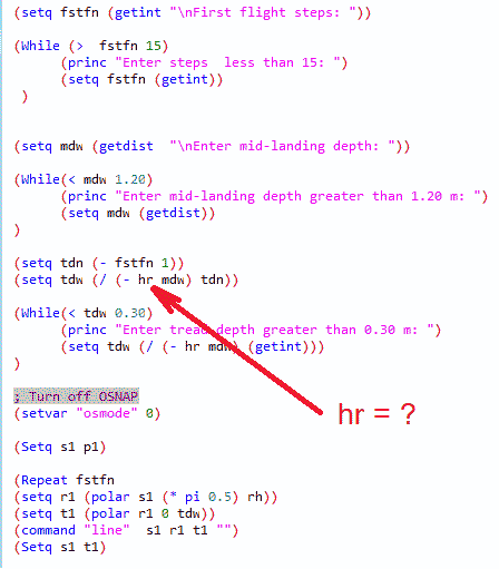

maahee Posted July 5 Share Posted July 5 (edited) (defun c:Stair () (setq p1 (getpoint "\nEnter first insertion point: ")) (setq p2 (getpoint p1 "\nEnter second insertion point: ")) (setq flh (getdist "\nEnter floor height: ")) (setq fln (getint "\nEnter number of floor: ")) (setq rsn (getint "\nEnter number of riser: ")) (setq hr (getdist "\nEnter horizontal run: ")) (setq rh (/ flh rsn)) (setq td (- rsn 2)) (while (> rh 0.190) (princ "\nPlease enter height less than 0.190 m:") (setq rh (/ flh (getint))) ) (setq fstfn (getint "\nFirst flight steps: ")) (While (> fstfn 15) (princ "Enter steps less than 15: ") (setq fstfn (getint)) ) (setq mdw (getdist "\nEnter mid-landing depth: ")) (While(< mdw 1.20) (princ "Enter mid-landing depth greater than 1.20 m: ") (setq mdw (getdist)) ) (setq tdn (- fstfn 1)) (setq tdw (/ (- hr mdw) tdn)) (While(< tdw 0.30) (princ "Enter tread depth greater than 0.30 m: ") (setq tdw (/ (- hr mdw) (getint))) ) ; Turn off OSNAP (setvar "osmode" 0) (Setq s1 p1) (Repeat fstfn (setq r1 (polar s1 (* pi 0.5) rh)) (setq t1 (polar r1 0 tdw)) (command "line" s1 r1 t1 "") (Setq s1 t1) ) (command "line" t1 "@1.5<0" "") ; Turn on OSNAP (setvar "osmode" 511) (princ) ) Enter mid-landing depth greater than 1.20 m: 1.2 ; error: bad argument type: numberp: nil while function not carry value of point Edited July 5 by maahee Quote Link to comment Share on other sites More sharing options...
fuccaro Posted July 5 Share Posted July 5 1 Quote Link to comment Share on other sites More sharing options...

maahee Posted July 5 Author Share Posted July 5 6 hours ago, fuccaro said: (setq hr (getdist "\nEnter horizontal run: ")) Quote Link to comment Share on other sites More sharing options...
BIGAL Posted July 5 Share Posted July 5 Very nice @marko_ribar. @maahee there is rules about stairs re rise and run. A better approach is to pick start point ground floor and end point 1st floor then work out the rise and runs. Quote Link to comment Share on other sites More sharing options...
