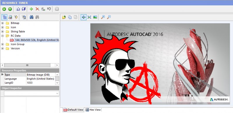

for 2016
open C:\Program Files\Autodesk\AutoCAD 2016\AcBrandRes.dll in Resource Tuner, export RCdata/dib, save as bitmap, edit as you like and replace it back in dll.

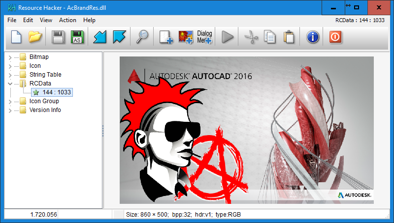

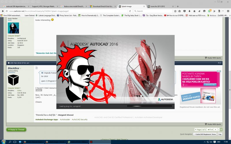

This is what i mean.
but I do not get what you mean... please explain, I'd love to understand.
tip... When saving dll save it to desktop, than copy paste to C:\Program Files\Autodesk\AutoCAD 2016\AcBrandRes.dll
and... dib is actually png, replace it with png and it will still show dib in reshack or other editor.
Edited by ibach
It's been +/- 7 years since I last had anything to do with the OOTB splash, and ^^ this ^^ is exactly the reminder I needed :beer:
I attempted to edit the resource assemblies in-place (within the install folder, after making a backup of course, like I do with my Visual Studio projects), which was unsuccessful - copying the resource assembly to Desktop (or other owned folder), editing the splash, and then copying it back to the install folder works perfectly.
