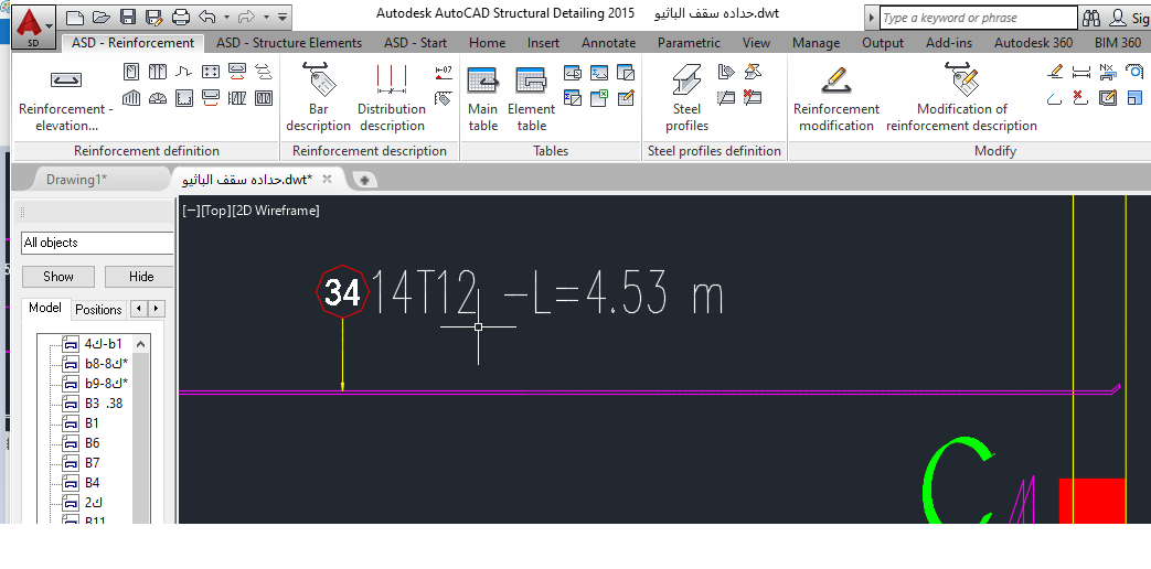

سبع الليل بتنون Posted July 3 Author Share Posted July 3 (edited) On 6/30/2024 at 8:11 AM, BIGAL said: 1st answer there is structural software add ons out there to do reo drafting. Yes it may have a cost. 2nd answer the software will draw different shape reobars. 3rd answer can then look at getting details of reobar. Dia, type and length. Thank you Mr Bigal for your response. It is indeed a version of AutoCAD, similar to Civil 3D or ArchiCAD, but it specializes in creating rebar details. It was released in 2014 and 2015, but then Autodesk completely discontinued it. The aim is to try to develop or adding Some routines that enhance its productivity. here is the program interface Edited July 3 by سبع الليل بتنون Quote Link to comment Share on other sites More sharing options...
سبع الليل بتنون Posted July 3 Author Share Posted July 3 On 6/30/2024 at 4:15 PM, SLW210 said: Can you post a drawing? Are you using AutoCAD (2015 is in your profile) and trying to modify objects from AutoCAD Structural Detailing? What exactly are you trying to do with the objects? Thank you Mr SLW210 for your response. It is indeed a version of AutoCAD, similar to Civil 3D or ArchiCAD, but it specializes in creating rebar details. It was released in 2014 and 2015, but then Autodesk completely discontinued it. The aim is to try to develop or adding Some routines that enhance its productivity. here is the program interface Quote Link to comment Share on other sites More sharing options...

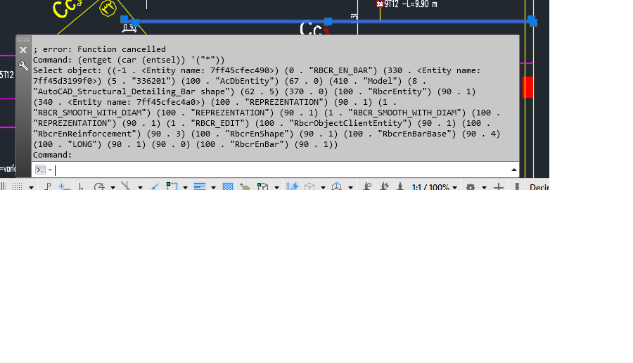

سبع الليل بتنون Posted July 3 Author Share Posted July 3 (edited) when I write (entget (car (entsel)) '("*")) I got something like this Command: (entget (car (entsel)) '("*")) Select object: ((-1 . <Entity name: 7ff45cfece90>) (0 . "RBCR_EN_BAR") (330 . <Entity name: 7ff45d3199f0>) (5 . "336299") (100 . "AcDbEntity") (67 . 0) (410 . "Model") (8 . "AutoCAD_Structural_Detailing_Bar shape") (62 . 5) (370 . 0) (100 . "RbcrEntity") (90 . 1) (340 . <Entity name: 7ff45cfecea0>) (100 . "REPREZENTATION") (90 . 1) (1 . "RBCR_SMOOTH_WITH_DIAM") (100 . "REPREZENTATION") (90 . 1) (1 . "RBCR_SMOOTH_WITH_DIAM") (100 . "REPREZENTATION") (90 . 1) (1 . "RBCR_EDIT") (100 . "RbcrObjectClientEntity") (90 . 1) (100 . "RbcrEnReinforcement") (90 . 3) (100 . "RbcrEnShape") (90 . 1) (100 . "RbcrEnBarBase") (90 . 4) (100 . "LONG") (90 . 1) (90 . 0) (100 . "RbcrEnBar") (90 . 1)) this entity doesn't exists in autolisp so what can i do if i want to entmake an entity like this ?? number , dia of bars are extended entities for this entity >>>> what will i do if i want to change these properites via lisp ?? or what is the programming language ?? or attributes type ?? or dictionaries that used to make this entity ??? Edited July 3 by سبع الليل بتنون Quote Link to comment Share on other sites More sharing options...
