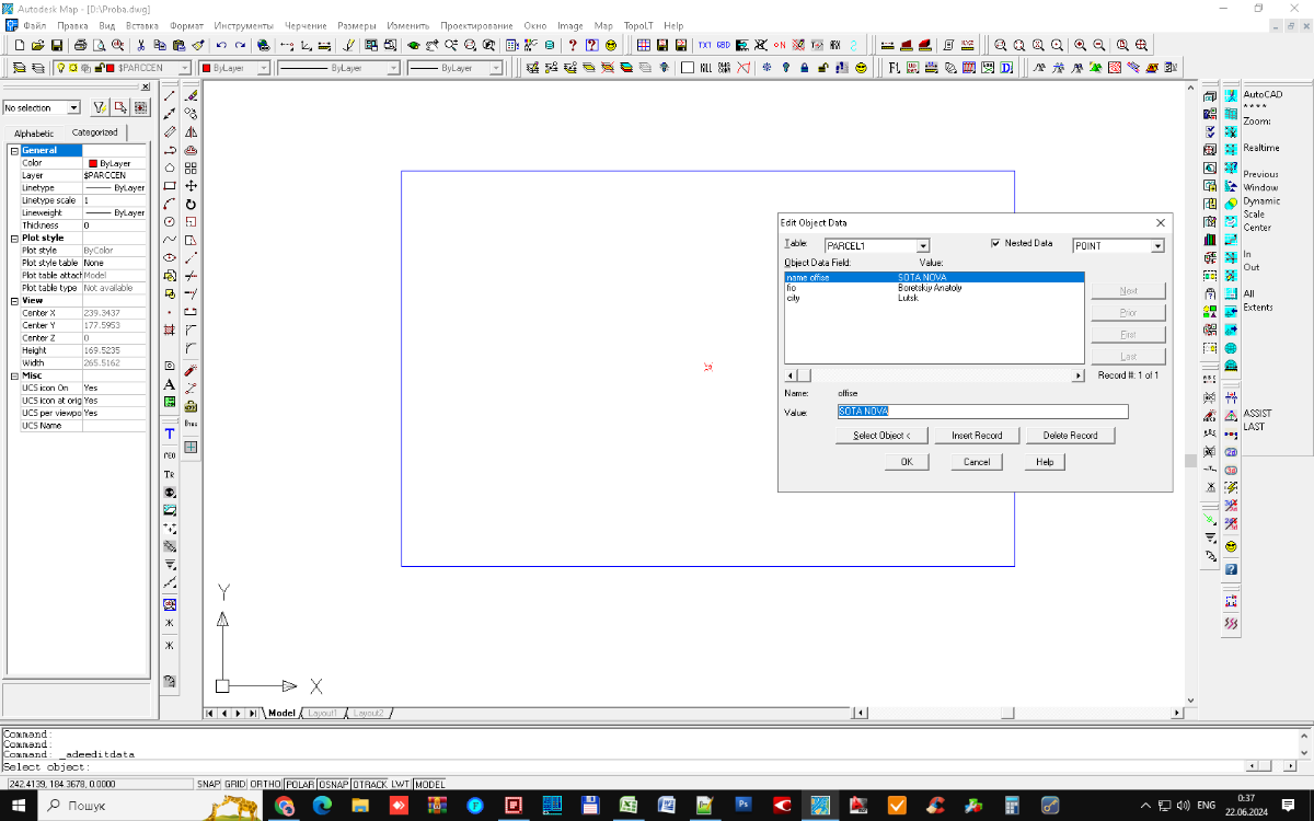

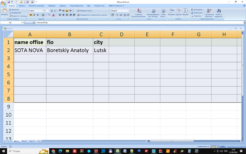

boretskiy Posted June 21 Share Posted June 21 Can anyone help me how to transfer object data from centroid table from AutoCAD Mep to Excel using Lisp. Proba.xlsx Proba.dwg Quote Link to comment Share on other sites More sharing options...
BIGAL Posted June 23 Share Posted June 23 I use Bricscad so can not see the table. If it's a normal Autocad table in MEP try this. table to excel.lsp Quote Link to comment Share on other sites More sharing options...
boretskiy Posted June 23 Author Share Posted June 23 Sorry, not AutoCAD MEP, but AutoCAD MAP Quote Link to comment Share on other sites More sharing options...
BIGAL Posted June 23 Share Posted June 23 I can not help my Bricscad V20 does not have the OD functions that you need, Google for help "See the help for (ade_od"function") especially for Acad Map" Quote Link to comment Share on other sites More sharing options...
tombu Posted July 10 Share Posted July 10 AutoCAD Map 3D AutoLISP: https://documentation.help/AutoCAD-Map-3D-2009-AutoLISP/object_data_functions.htm Quote Link to comment Share on other sites More sharing options...
