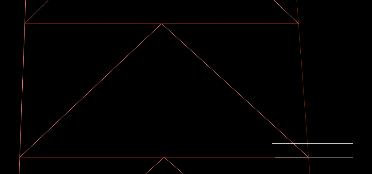

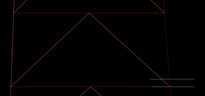

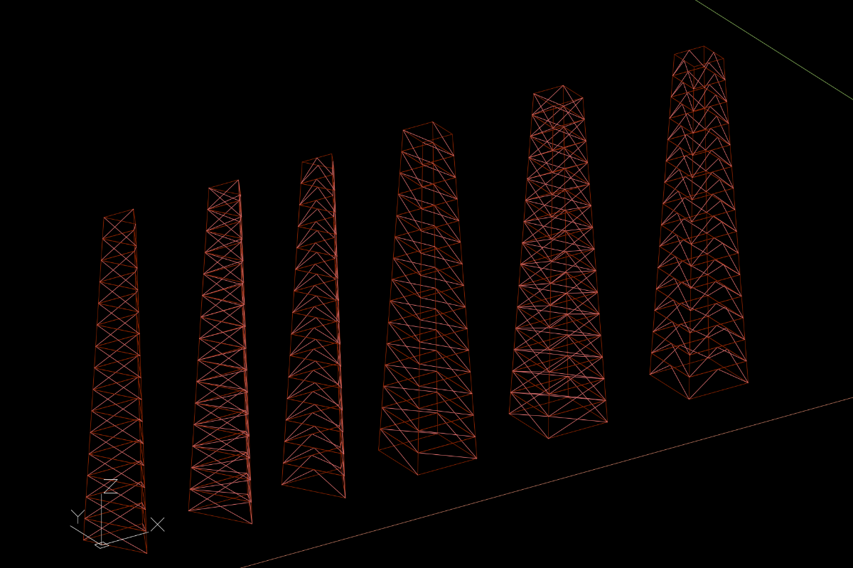

So basically this routine is creating a 3D stick model of a tower with specified segment height (that is the portion between each horizontal line), and connects the lines based on the base width and highest elevation width to form a trapazoidal/ conical shape as it graduates upward and in 2 flavours (3 legged and 4 legged supports).
I cannot figure out the following no matter how much I tried:

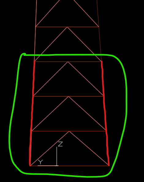

1) I need to create a spacing between the diagonal bracings and the horizontal lines so that is user specified. Right now, every origin of the diagonal bracing starts at the end of the horizontal line. In some scenrios this is alright, but in many, i would need a vertical spacing of a user specified value to seperate the two as whon on my second photo.
2) The concept in general is wrong, as the number of segments should constitute the segments on the assembly that can be welded or bolted to bring to the site, what I have right now is small segments that will makeup the assembly but the tapared "main legs" should not be separated or broken (currently each segment is drawn to the point of intersecting with the next horizontal line). I would like to have "Assembly height" and then devise them into as many segments that makeup that portion on the assembly.

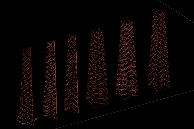

3) I would have liked to then (with #2 resolved) have the ability to chose what pattern bracing type I want for the next assembly (K/X/Z) onwards.

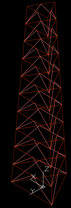

4) In VBA excel, with the help of simple graph, I can simulate what the tower would look like, and I am not sure if DCL and slides give me the preview (last photo is the userform in VBA, but I abandoned that idea and moved to lisp instead)
I apologize in advance if I did not comment the lisp as much as I should have, but instead used a long variable name to describe the function/ variable
I am sharing my thoughts and hopefully, you all wise people can share yours to solve my issues.

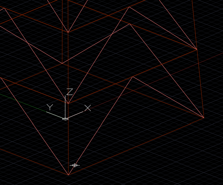

Some preliminary thoughts. I have zero experience with towers, so feel free to dismiss everything.
1) You could add a vertical spacing parameter, which defaults to zero. In the draw-line subroutine, add the spacing parameter to the Z coordinate; if it's zero, no harm done. Wait, the vertical member isn't perpendicular to the ground? Use the interpolation function to locate that point.
2) If you need the vertical members for each segment to draw the next one up, could you put them on a separate layer? Then, when you're done, draw one line up the whole structure and erase the individual members. Or draw the one line first.
3) It would help if there was some logic behind the type of pattern, such as "K bracing in base, X in transition" or "Z bracing for width > 5000, X otherwise".
Something else to consider: once you draw one side of the tower, can you mirror it or copy it correctly to make the other sides? That might save some effort and complexity.

A question (cond ((getint (strcat "\nEnter Number of Segments " would this not be based on some max distance ? Even if have rules re tower section height max spacing.
Please show 3 sided & 4 sided, K X Z shapes, dwg or image.
Is the sides,1 single line ? Did not wade through code to work that out.
Not sure why you need to make lists of points rather than just calc as you go.
- Yes, total tower height/ number of segments = each segment height (base on vertical distance, not tapered distance). in fact, all the unser input distances are based on a vertical distance and not the actual distance of the member. Since the original mesurements are given by the user based on a 2D elevation or plan view. In this way, I can then measure the real distance of any bracing/ tapered line.
- Please see attached DWG + the snapshots. I have included all the possible 3/4 sided tower and all the possible bracing types on the dwg file.
- That is the ONLY way I knew, that is through list and interpolation. I have a long way to get to your level of thinking and data processing @BIGAL.
Thank you @BIGAL for taking the time to take a look at my problem.
Tower Example.dwg
Understand more now your drafting in 3D yes a complicated task. Will have a think about it and look at code again.
One maybe easier way is draw each side in 2d and user Rotate3d. For the 3 sided that is pretty easy as just use copy 3 times. The 4 side again lay down in a left right up down pattern and stand up as 2 sides will not have the long edges.
@Sambuddy In response to your first question, the following code with determine the location of a point on a diagonal at a given vertical distance (i.e., in the z world direction) from the lower point of the diagonal going from point A to point B.
