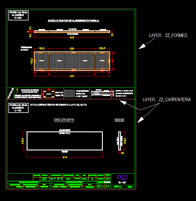

I have created a lisp that I routinely use to successively print various boards (A4 and A3 size), arranged in model space.
Basically, the command asks to select the tables I intend to print and as print coordinates it uses the frames (lwpolyline) it finds on layer "ZZ_FORMED".
(setq selpol(ssget
(LIST
  (cons -4 "<AND")
  (cons 0 "LWPOLYLINE")
  (cons 8 "ZZ_FORMED")
  (cons -4 "AND>")
The problem arises when by mistake, there are 2 overlapping panes, or one is inside another: e.g., the format frame that is also on layer "ZZ_FORMED", instead of on another layer that the lisp would ignore.
In these cases my drawing is mistakenly printed 2 times, once by taking the correct format and the other by taking the slightly smaller frame.
I would therefore like to find a way to find the error, which would allow me to stop my lisp and report the incorrect frame .... with a nice circle!

If you know the correct area of the polyline, it is very easy to check which polyline is wrong.
(vla-get-Area obj)
On this page there's a function that detects overlapping polylines. According to the provider, it creates regions for both, subtracts one from the other, and compares the new area to the old. If all your plines are closed, it should work for you.
The best suggestion of course is to use layouts and problems go away.
Why is an inner frame on same Layer if you dont want to use it ? Put it on similar layer ZZ_FORMED_IN"

In the company we CAN'T use layouts (the boss doesn't know how to use them... so we don't use them!), consequently we put all the drawings of the boards on template space.
The inner frame is on the same layer only by mistake: so I happen to print the same drawing 2 times.
Sometimes we need to print the drawing in A3 size (example: Armature and Carpentry of a panel), and then print only the Carpentry on A4 size.
For this we put the smaller format on another layer.... only by mistake it ends up on ZZ_FORMED.
My luck is that we always deal with polylines without arcs and with 4 points (the A3 to A4 format), so it is not difficult to find the center of gravity by means of a crossing and the INTERS command.
So as I wrote earlier, I will go through the various polylines one by one, extract their center of gravity and check if this center of gravity is also inside another polyline....

@X11start  Just add the dxf code for color
(setq selpol-a4  (ssget
(LIST
  (cons -4 "<AND")
   (cons 8 "ZZ_CARPENTERIA")
    (cons 62 colornumber) ; seem to be orange
  (cons -4 "AND>")
or
(setq selpol-a3  (ssget
(LIST
  (cons -4 "<AND")
  (cons 62 colornumber) ; seem to be gray 9
  (cons -4 "AND>")
