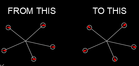

Hello, can anybody help me with the lisp routine that can rotate multiple blocks placed at the end of polyline in the direction of polyline?
I think this can be done by considering the reference that all the polylines are drawn from center to outward direction.
Please see the attached CAD file for reference.

how about placing them anew?
made a function like that recently just changed it a bit

or this would allow you to change the relativ angle for the block placement wich is more like what i originally used

@EnM4st3r Just checked both the codes. The first one is the one i wanted. cheers mate. much appreciated. Tomorrow i will run on my actual file that contains around 2500 plines. Thank a lot once again. ❤️
