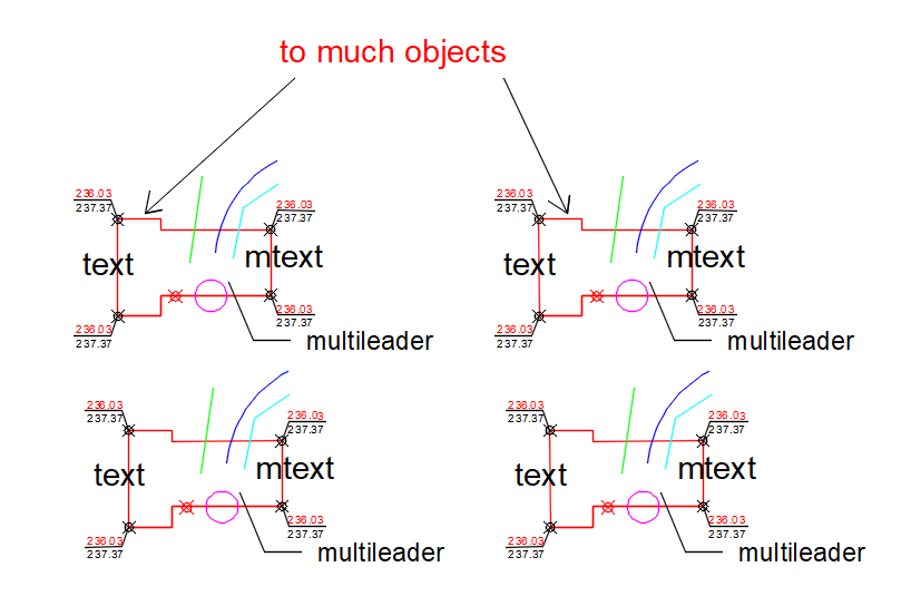

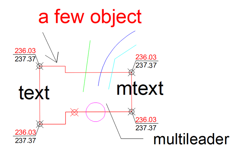

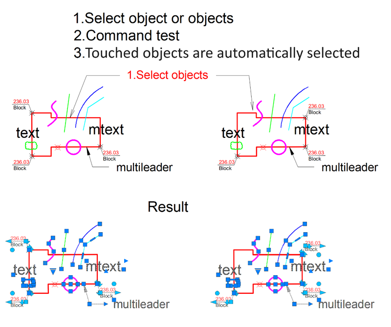

Good day Mr. Bigal,
Please see attached foto and video
1.Select object or objects
2.Command test
3. Touched objects are automatically selected
When the selected object(Red Pline) is few(1 or 2 pcs.), it works normally,
but when the selected objects (Red Pline) are too much(100pcs.),
Process takes too much time or error.
Edited by macros55
I updated code above and got 1189 objects. Instantly.

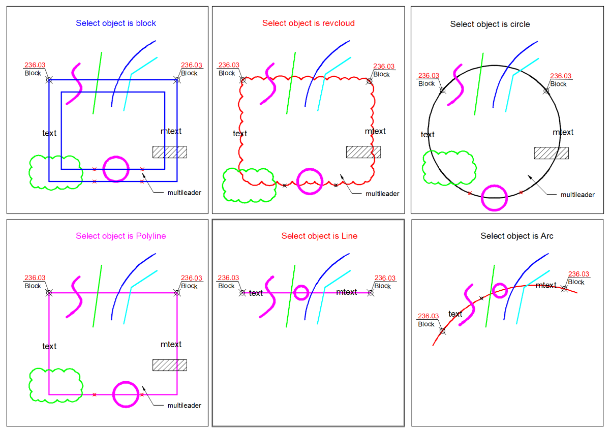

i have small polylines and DW text on it. so i want select those polylines and change those pl into another layer.
all polylines are in same layer so, i have this text to select the overlapping objects.
@srikanth_0126 Mr, if you need a different lisp, please open a new topic.
My topic is to select other objects that touch the selected objects.
Hi @macros55,
its a same thing but, i select text objects to select touching polylines.

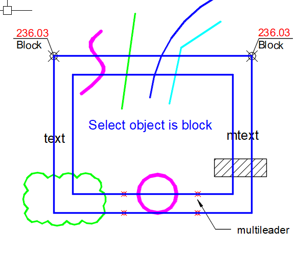

@Exceed Mr, I need to select other objects that touch the selected objects. But not only selected Pline, sometimes " 3dpolyline, line, block, circle text, mtext, etc."
Any start with this?
This mainly deals with curvilinear entities

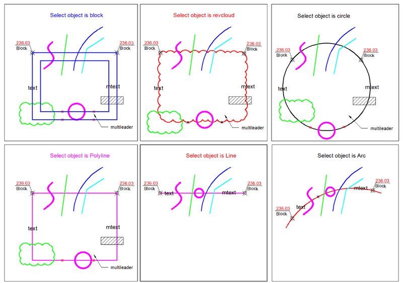

Mr Tsuky,  Good day, It's good to see you again. how are you?
I tried some object (circle, line, arc)working ,but other (pline, block, point, text,revcloud, etc.) not working.
I need for all of objects
Please see attached test ss3.dwg file.
test ss3.dwg
I fixed my code, please reload it from my previous post.
This works for any curvilinear entity.
It can also work for a block if it is made up of nested curvilinear objects.
