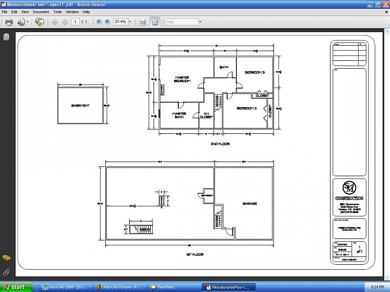

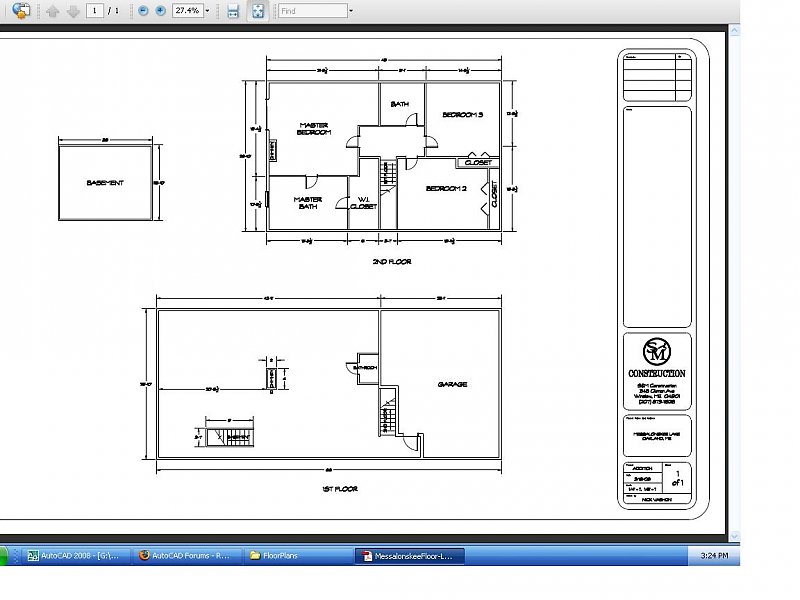

nicnicman Posted March 20, 2009 Author Share Posted March 20, 2009 My boss wants me to send him a floor plan in .pdf format. The plot preview looks fine in autocad but when I plot it as a .pdf (using dwg to pdf in autcad) the border and drawing are off center. I used a window and centered the plot. Attached are screen shots of the plot preview in cad and the .pdf file Any help is appreciated. Edit: The plot preview is in the following post. These are both screen shots of the pdf plot Quote Link to comment Share on other sites More sharing options...

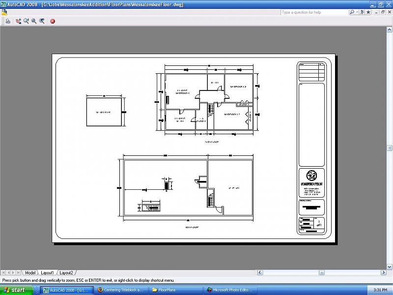

nicnicman Posted March 20, 2009 Author Share Posted March 20, 2009 Sorry about that. The previous attachments are both the pdf files. Here is the screenshot of the plot preview in autocad. Quote Link to comment Share on other sites More sharing options...
