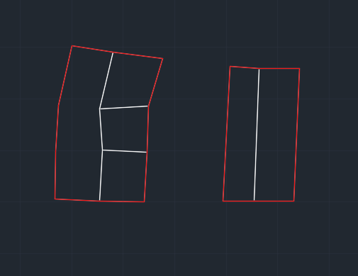

lastknownuser Posted June 11 Share Posted June 11 (edited) Wanted to ask what would be the best way to get all outer regions of selected lines. Image attached, want to select only the outer regions marked red. My idea was to loop through all created regions, determine the one with largest area, then check if that one intersects with other, if yes remove them from selection set. If any left do it again, if like in this example there are two separate, not connected areas. Is there any better, faster way to do that? Also question about intersection, if I select two regions that are touching in for example 3 points, I get a list of length 24 (8 points), so I have double points. I plan to use those points also later for something, is it possible to avoid these doubles? Or I'll have to filter those Here is the code I use to get intersection (vlax-invoke (vlax-ename->vla-object (car (entsel))) 'IntersectWith (vlax-ename->vla-object (car (entsel))) acextendnone) Edited June 11 by lastknownuser Quote Link to comment Share on other sites More sharing options...

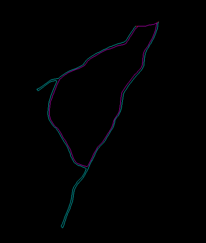

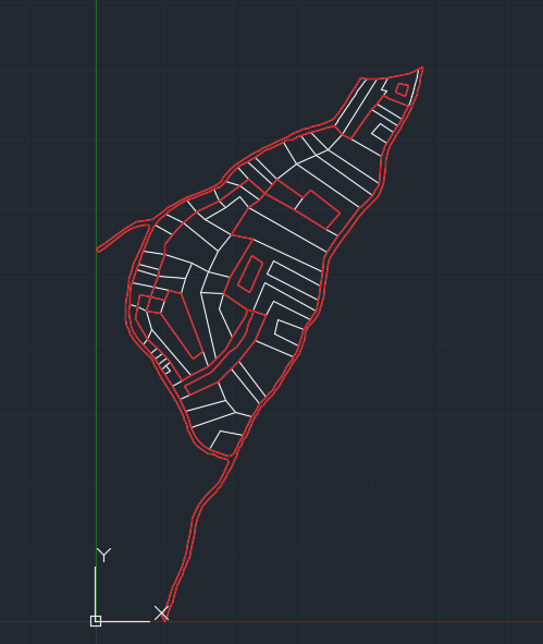

lastknownuser Posted June 12 Author Share Posted June 12 No civil available unfortunately, even though I think AutoCAD map would be more suitable for my needs, not sure. I need something very specific, and something I can change/adjust by the needs, so I'd rather do it myself, I know I can make it, I have the idea, just trying to figure out the best, most efficient way to do it. I attached sample dwg of some made up area. Method you described makes more polylines than needed (photo attached), but what is the real problem for me are missing vertices (I drew red arrow where they are missing). At least they are missing for me on my AutoCAD. And like in first post, I can have many areas like this separated (smaller or bigger), which complicates things, and I'd like to outline them all at once OUTER BOUNDARY TEST.dwg Quote Link to comment Share on other sites More sharing options...
