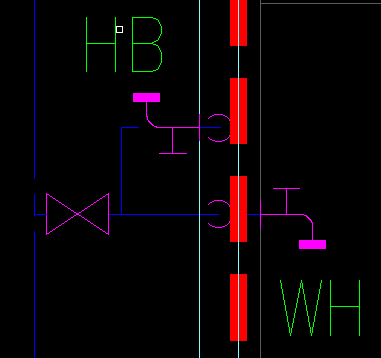

I have a lisp that I have modified from www.afralisp.net and It does everything thing I want now but I can't figure out how to ask the user if they would like to mirror the block! I want it to happen after the block is placed so you can see the block there. The example for it is the hosebib with the HB next to it, see how it is upsidedown.
(command "Insert" "HBAB" "s" (getvar "dimscale") ip pause pause "" "")
I think I would change the pauses to points and use those as the line I mirror off of, but I have never done this so I have no clue how to make those in to point to reference. If some can help I will be so thankful!!!!

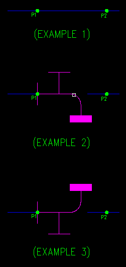

I think I said it wrong sorry. Below is another picture. I have a block that is magenta and I need it to ask if I like to mirror it after it places it. My insertion point is P1 and P2 is the second point that determines the angle of the block. I need it to ask if I like to mirror the block along P1 and P2 and get the end result of the gray block next to the magenta block. I hope this helps!!!!
Well then maybe:
(initget "Yes No")
(setq ans (getkword "\nMirror Block? [Yes/No] <No>: "))
(if (= ans "Yes")
  (command "_mirror" (entlast) p1 p2 "n"))
I run the lisp hosebib. It ask for insertion point (that is going to be p1 in example 1) and then requires a second point to define the angle of the block. (that is going to be the p2 on in example 1). When that is done the finished running lisp looks like example 2. I want it to know ask "Mirror Block?" [Yes/No]. If I hit yes the end product will look like example 3 using p1 and p2 at the mirror line points. If I hit no it will cancel out and do nothing. I hope this helps on what I am looking for.

   (initget "Yes No")
   (if (= ans "Yes")
     (command "_mirror" blk "" ip1 ip2 "_Y"))
   (setvar "OSMODE" 544)))

   (initget "Yes No")
      (if (= ans "Yes")
         (command "_mirror" en "" ip1 ip2 "_Y"))
