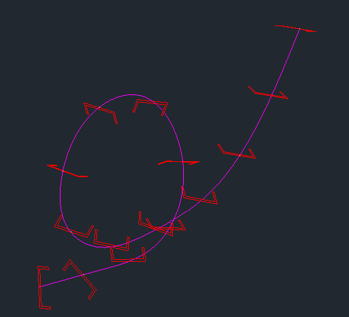

I have found that the sweep command provides very limited control of the twist in sweeping a cross section along a spline.  To get some local control on twist I took the strategy of using loft  to create the "sweep" effect. The following  LISP program is a work-in-progress (i.e., still buggy)   to provide an initial placement of the sections prior to using loft.
Here's the workflow to use it.
1. Create a block of the cross section.  The profile should be a single polyline with the block's base point on the centerline.  The z axis of the block will be tangent to the spline.
2. Execute the program and specify the number of loft sections you want, the name of the block, the start twist angle, and the total twist from the start of the spline to its end.
After running the program you can individually rotate section as desired.  Just use the UCS OB command and the rotate command to rotate the block about its Z axis to the orientation you want.
Explode all the block after getting the their rotations as needed and then give the loft  command.
Note, to get the twist reference point the program takes the cross product of the first derivatve ( the slope) and the second derivative (the change in the change of the slope). Where the curvature of the spline is fairly flat this can yield undersirable results.
The program needs some additional debugging but I have found it useful as is.

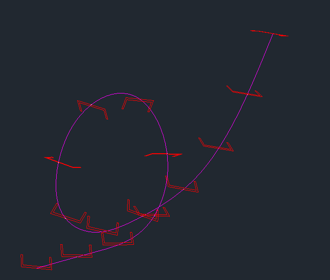

Here are the results with 15 sections and a start twist angle of 0 and total twist angle of 0.  Note that the first section needs to be rotated by about 90° and the second by about -135°
Here's the results after the two rotations.

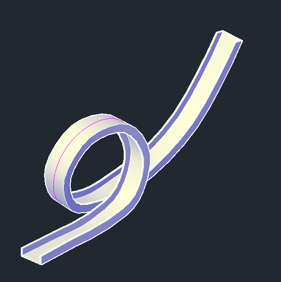

The results after exploding the blocks and lofting.
