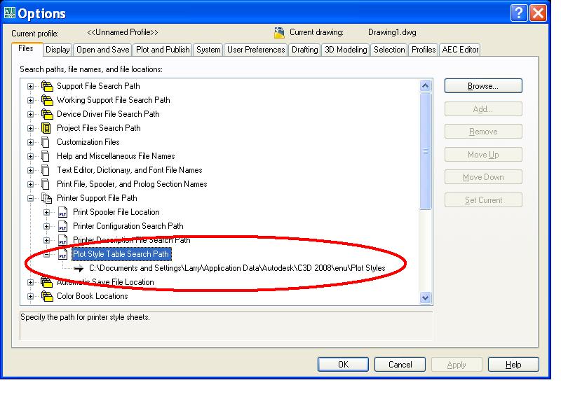

In 2006 look under Tools > Options. In the Options dialog box click on the Files tab. Under Search Path...click on Printer Support File Path. Under that heading click on Plot Style Table Search Path. Expand that category and note the path that starts with C:/Documents........................
Your plot styles should have been migrated over when you went from 2006 to 2009. It's an option that is oft overlooked.
Assuming 2009 is similar to 2008 (and 2006) you can find them as shown (Options > Files)
