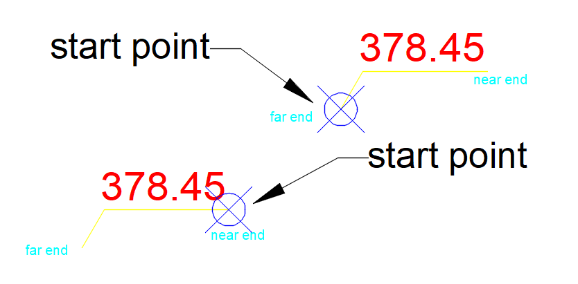

Mr. @Tsuky,
Yes,  I used that code.
For example please check this area, coordinate x,y 2517.9362,642.7231
Indeed, this is due to the polyline segment which is not perfectly parallel to the orientation of the text.
What you can try to do is increase the tolerance at line 100. For exemple:
(if (equal (rem (angle (car l_vtx) (cadr l_vtx)) pi) (rem ang pi) 7E-02)
If this is not enough, increase further within reason.
For Tsuky working on it. Busy working on a house reno.
"Some points have been added in the opposite direction. What could be the reason for this?" one of the things I was looking at was the direction of the drawn pline, if you say put a point on end of pline it may be wrong end, as I am still working on it not sure if lines are consistent direction. Will find if a problem.
Gentlemen,
From what I understand, LISP always adds a dot to the start point of the line.
Is it possible to add point to the end of the Pline that is farthest from Text?
Is it possible to solve this problem like this?

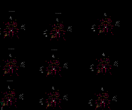

Ok 1st go 1431 text objects about 2 seconds to change, as per 1st sample dwg supplied. The little search window can be done better. Ver 2. Entmake a point speed increase also.

Macros55 the answer to the question of point at wrong end may be solved simply, by answering this question, if these text and plines are generated in some way why are some drawn in reverse direction ? Are you using a lisp to generate them ? That lisp needs to be corrected so line always goes in correct direction. Looks like a MIrror function that needs a Pedit Reverse if implemented.
Edited by BIGAL
4 hours ago, macros55 said:
Gentlemen,
Here is the test that seems to solve the point placement problem.
(if (equal (rem (+ 0.01 (angle (car l_vtx) (cadr l_vtx))) pi) (rem (+ 0.01 ang) pi) 7E-02)
So this tests the angle (in radians) of the polyline segment and the orientation of the text.
The presence of (+ 0.01) is to allow the passage of an angle slightly lower than PI:4th quadrant to the 1st quadrant.
REM is used to compare the angle from 0 to PI
EQUAL to have a close tie at 0.07.
After a quick observation of the drawing after execution, the points seem well placed, but I was able to miss a poorly placed point...

Speed and more speed, your home work is change the (command "point" pt) to a entmake function, just did 1590 text checks and with code change was like blink and you missed it ALL DONE. Took longer to select and press enter than convert.
