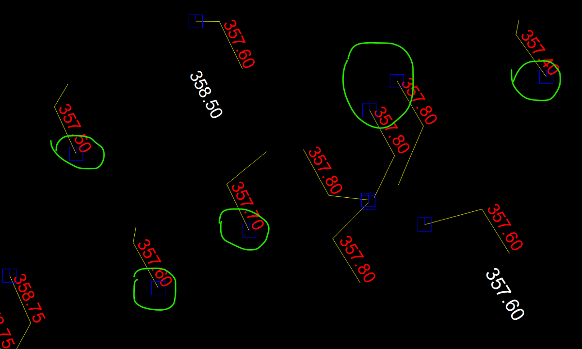

macros55 Posted June 3 Author Posted June 3 (edited) Good day Mr Tsuky, I have checked very good job thank you very much, just I have a small comment in red cloud. Could you please see attached dwg file rev2. Point to Text-Polyline rev2.dwg Edited June 3 by macros55 Quote
Tsuky Posted June 3 Posted June 3 In fact, I noticed this malfunction before publishing my response. I looked for something in the code that could do this without processing, but I couldn't find it. By restarting the function on the unprocessed texts, they are then processed correctly. Sorry but I can't find the cause in my code that creates this malfunction. Do any other commenters have an idea? I think we need to look into (ssget '_C' pt_inf pt_supp '(.....)), I tried several things, without convincing results. Graphical selections are often problematic: (zooming to entity first in code before selection?) Quote

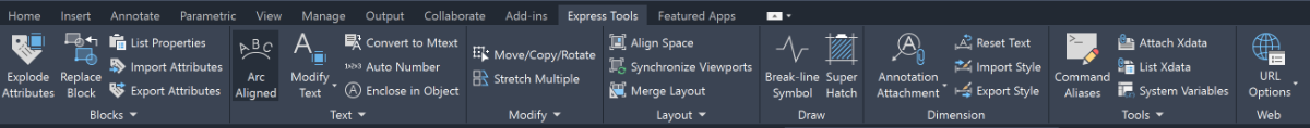

Tsuky Posted June 5 Posted June 5 (edited) 2 hours ago, Tsuky said: @macros55 NB: I use the functions (acet-ui-progress-...) to display a progress bar. If this function is blocking execution for you, you can comment on lines 48, 50 and 131. This will have no impact on the running of the program. Commenting out a code consists of placing a semicolon ";" at the start of the line You don't have ExpressTools installed? They are the ones who offer this function. Edited June 5 by Tsuky Quote
macros55 Posted June 5 Author Posted June 5 Mr @Tsuky I have installed the Express Tools, but I didn't got your point. Could you please share me by video link? Quote
Tsuky Posted June 5 Posted June 5 This is not important, it just displays a progress bar that shows the processing progress. You can do without it... However, if you want to test, copy and paste the following directly into the command line by validating with enter. ((lambda ( / size i) (setq size 100000 i 0 ) (acet-ui-progress-init "Working:" size) (repeat size (acet-ui-progress-safe (setq i (1+ i))) ) (acet-ui-progress-done) (prin1) )) You will have this: I reattach the lisp without this progress bar. Simply wait 10 to 20 minutes depending on the power of your PC add_pt_with_text&poly.lsp Quote

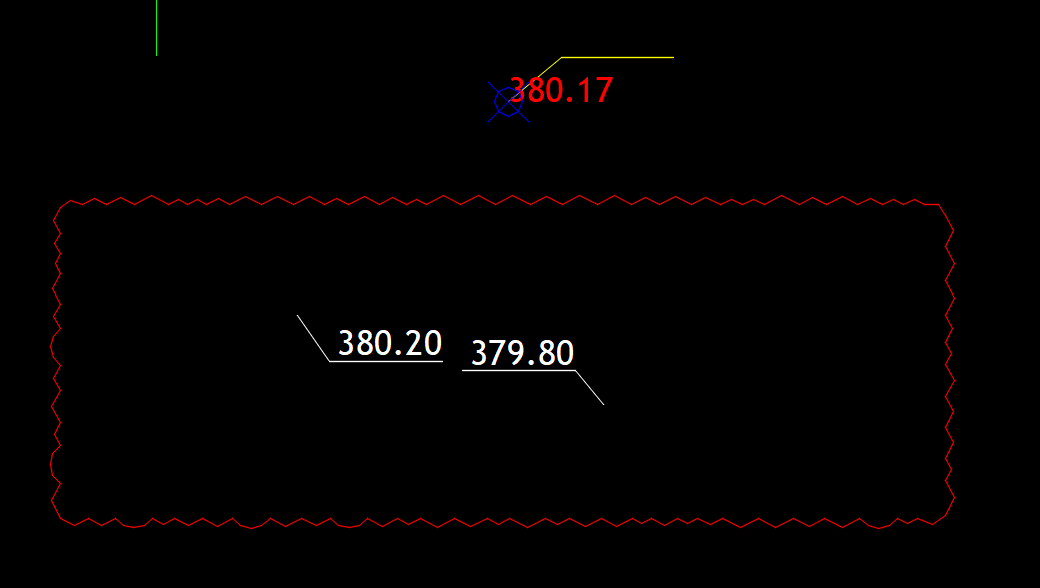

macros55 Posted June 5 Author Posted June 5 Mr @Tsuky Some points have been added in the opposite direction. What could be the reason for this? Quote
Tsuky Posted June 5 Posted June 5 What code are you using? Because in the last delivered "add_pt_with_text&poly.lsp" this problem no longer exists! See my message https://www.cadtutor.net/forum/topic/86167-add-a-new-point-to-the-end-of-the-polyline-near-mtexttext/?do=findComment&comment=642684 Quote
