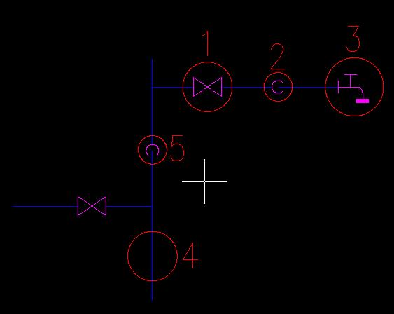

neekcotrack Posted March 17, 2009 Posted March 17, 2009 I am looking for a lisp that can help draw pipe and insert blocks and trim the pipe to the blocks. See attached picture for Reference. This is what I am look for in a lisp: 1. Load lisp and run it. 2. Command line prompted for: Pipe,Pipe Down,Pipe Up,Hose Bib,Value Example: Drawing pipe item 4 below and pipe down comes up you do pipe down and the block 5 is inserted and trims the item and draws pipe again. I hope this give a good Idea what i am try to do. I am try to get the command prompt to come up after every command and only exits if esc is hit. Thanks in advance for everything!!! Quote

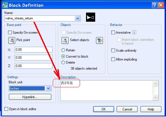

fixo Posted March 17, 2009 Posted March 17, 2009 Another way to add description in every block def Inside parenthesise are distances at right and at left from insertion point See pic ~'J'~ Quote
BIGAL Posted March 18, 2009 Posted March 18, 2009 I have not written the lisp but rather the sequence Setq ans to say P for pipe first then while ans /= nil cond P run defun pipe D run defun down U run defun up etc lastly please enter choice p d u etc if you press enter this equals a nil hence while exits Hope this helps it won't trim the blocks but will repeat prompt I am sure if you know your block characteristics size in each direction then you can work out the trim problem you need to save these for each block in the lisp or alternatively I would have a text file that you could change if you change your blocks. block1 L R U D Quote
